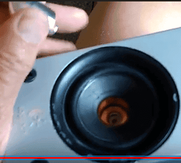

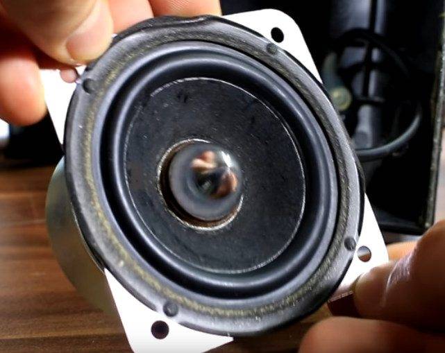

My son asked me to look at his Logitech Z-2300 system (Amp, sub-woofer and 2 satellite speakers) that was acting up. He had already taken a lot of it apart to see if he could find a loose connection. In checking things out, I found this part in with all the screws and loose hardware. It's the center, shiny part in the middle of the speaker in the picture ("driver" is a better term in audio circles, "speaker" generally refers to the whole system of drivers(s), crossover(s), cabinet, etc).
I got that 1st pic from the internet, I'll try to get a screen grab of the loose part from the video I took to document as I went (sorry for poor quality). It is slightly smaller diameter than the voice coil, and then a smaller 'stud' at the bottom end. The bottom of the 'hole' in the driver is solid metal (looked like copper). Typically, a shiny dome like this is lightweight and part of the driver cone, meant to act as a stiff diaphragm for the high frequencies. But this piece does not move at all.
It would rattle a bit being loose, so I added a small drop of epoxy at the bottom to hold it in place. But I don't know the function, and I didn't find anything specific in my searches. Other then decorative, is it a heat sink? I forgot to check its magnetic properties, pretty sure it's all aluminum though, but if not, could it constrain the field for the voice coil? That pale red ring/washer looked to be fiber, maybe it was just glued or press-fit at that point? Is it meant as some kind of horn/wave-guide?
Any info would be appreciated, I'm just curious.

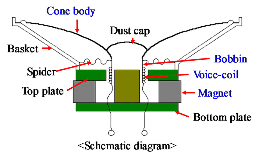

@NTL2009 -- Can you point to which parts of a traditional speaker you think that is?
https://www.researchgate.net/publication/288727113/figure/fig1/AS:398589600780288@1472042575149/Schematic-of-a-general-speaker.png
See if this mod to that drawing helps. It's like there is no dust cap at all. This center "bullet" seems to be mounted to the base plate - it is fixed, it does not move with the cone. Small air gap between the "bullet" and the inner diameter of the voice coil.
I see references to a phase plug, but I'm not so sure. That seems to be applied with a compression driver feeding into a horn. I'll try to get some of those links, but first I'll post my mod to your drawing.

A few youtube links - In the 1st, a guy cuts out the dust cap and inserts a "phase plug" which is glued to the base, similar to what I'm seeing. He's just "some guy" though, I have no idea of the merit to what he's doing.
Some similar looking mods to woofers in this one, using a copper pipe, but he doesn't show the construction, but I assume the pipe is mounted to the base, it would be awful heavy for the cone.
And here's one that they call a "phase plug", but it moves with the cone. Confusing.

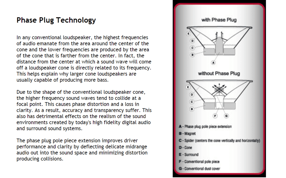

From the linked wikipedia article:
Phase plugs are commonly found in high-powered horn loudspeakers used in professional audio, in the mid- and high-frequency bandpasses, positioned between the compression driver diaphragm and the acoustic horn.​
However, a coned speaker can have a phase plug, too ##-## from reference '17.' in the article ##-## https://web.archive.org/web/20030414152835/http://www.preference-audio.com/phaseplug.htm:

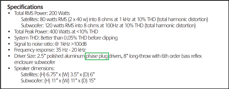

In the Logitech Z-2300 system, phase plugs are present in the 2.5" drivers ##-## from the Setup guide at https://www.logitech.com/assets/35688/setup-installation-guide.pdf ##-##
Likes NTL2009
Ahh, very good, thank you! That second diagram explains why they would be used in a mid-range driver. And combined with the last link I'd say it's definitive - Logitech calls it a phase plug as well.
Mystery solved! And my drop of epoxy was probably the right thing to do.
