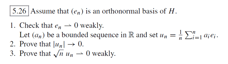

This is a problem from Haim Brezis's functional analysis book.
I'm assuming (e)n is the vectors like (e)1 = (1,0,0), (e)2=(0,1,0) and so on.
We know every hilbert space has an orthonormal basis.
I also need to know the difference between l^2 and L^2 spaces. I know that this might not be much of a solution, but I'm really stuck.
You could start by stating clearly what weak convergence implies (here in the context of a Hilbert space).
Once you have a clear understanding of weak convergence, 1. and 2. shouldn't be too difficult.
As (##e_n)## is an orthornormal basis of the Hilbert space H, you can use ## \forall x \in H: x= \sum_{i=1}^\infty <x,e_i>e_i## (series converging in the norm of the Hilbert space).
And also ##\forall x \in H:|x|²=\sum_{i=1}^\infty |<x,e_i>|²##.

I think I now have the answer to part 1 because you can use an idea from Parseval which automically shows that en weakly converges to zero. But I'm still not sure about what to do with an and un. I also think the boundedness of an plays a role.
For part 2 I know that this is showing strongly convergence, but I don't really get how to show abs(un). Do I just pretend that the summation is really a sequence?
Yes, that is correct.
You can compute an upper bound for ##|u_n|##, making use of the fact that ##(a_n)## is bounded, and ##(e_n)## orthonormal.
You can use that, in general, you have:
##|\sum_{i=1}^n b_ie_i|²=\sum_{i=1}^n |b_i|²## (where ##(b_i)## are any numbers), because ##(e_n)## is orthonormal.
