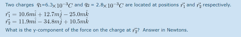

See attached
F=9E9qq/r^2
So first I did the vector stuff.
r2-r1= 1.3 i hat-47.5 j hat-14.5 k hat
magnitude = 49.68
magnitude squared = 2468.19
Now plugging it all in...
F=9E9*6.3E-3*2.8E-3/2468.19=64.322
y vector, -47.5/49.68=-0.956119 j hat
Multiply this by force and I get -61.499 but answer should be -36.14
JoeyBob said:
Homework Statement:: See attached
Relevant Equations:: F=9E9qq/r^2
Check the k component.
Thanks. The werid thing is that this I did this question a month ago and made the same exact mistake (my wrong answer is the same as the new wrong answer I just got).
