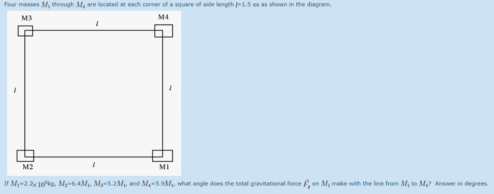

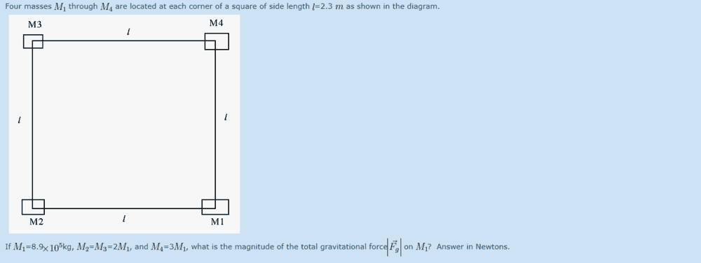

See attached
F=-Gm_1m_2/r^2
So what I did was find each of the forces the masses had on m1 using the above equation.
From m2 I found 19.975 in the negative i hat and for m4 i found 29.96 in the positive k hat direction using the above equation.
For m3 I used pythagorean theorem to calculate r, which was 3.25 (so r^2 was 10.58). I then used the above equation to get 9.987N. This force would act in the up direction, so I added it to my k hat to get 39.95 and to the left so I made it negative and added it to my i hat to get 29.96 in the negative i hat direction.
Then I squared and added the forces and square rooted them to get 49.937N, which is wrong. The answer is supposed to be 45.84.
I think I screwed up somewhere during the m3 part, but I am not sure how.

You need to split the force from m3 into components. You just need a little trigonometry for that. To add the whole amount to each of the x and y results from m2 and m4 is incorrect.

So I divide it by 2 and add it to each component?
Charles Link said:
That is also not correct. You need to learn about vector addition.
See https://mathworld.wolfram.com/VectorAddition.html
Wait that doesn't really make sense to me. It gives me the right answer, but the next question is like the same thing but it asks for the angle and the angles isn't 45.

Splitting the vector into components usually involves taking ## \cos{\theta} ## and ## \sin{\theta } ##.
For your first problem, ## \cos (45)=\sin(45) ##.

But how do we know the angle is 45? The second question asks for the angle and its the same type of problem and the angle is 46.79.
The force acted along the line joining the m1 and m3.
The force from m3 to m1 acts along the line connecting m3 and m1, that is the diagonal of square , so it makes angle 45 degrees. But this force is not the total force on m1, it is part of the total force. If you have understand that part about vector addition correctly, i think you can understand that the total force (which will be the vector addition of all those three forces) will have another angle.
Likes JoeyBob
