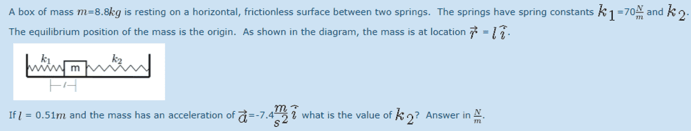

In summary, the equation to calculate the force from a spring is ma=-k1l-k2l, with the positive direction defined as to the right. The change in length is not taken as an absolute value in this calculation.
JoeyBob
256
29
See attached
F=lk
ma=-k2l+k1l
(ma-k1l)/l=-k
(-65.12-35.7)/0.51=-k
k=197.69, but answer should be 57.7

Sorry i had some wrong posts here which i deleted... Your mistake is in first line, you take one force as positive and the other as negative. Aren't both forces towards the same direction at position l?

Okay I found out how to do it but am a bit confused. To get the right answer it needs to be
(-ma-lk)/l
This would mean the equation is ma=-k1l-k2l
But doesn't this imply the forces are in the negative i hat direction when they should be in the positive direction??
On your picture which is the positive i hat direction? Is that the direction of the force when l is positive?
It would be to the right, no?
So you have to define positive x (you have called it l) in that direction also. Going to the left is negative.
Isnt the change in length an absolute value though when calculating the force?
No. The force from a spring is opposite from displacement. Hence the minus sign in ##F_x=-kx##.
