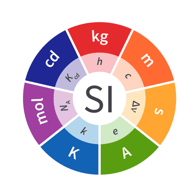

vanhees71 said:
Sorry if I'm being dense, but what does the inner circle of symbols mean? I understand the outer circle of symbols as being fundamental units, but only the "e" in the current sector of the circle makes any sense to me...
Likes Mr X
Those are the fundamental constants that define the unit. The second is defined by the frequency of the caesium hyperfine transition, the meter is defined by the speed of light, the kilogram is defined by Planck's constant, the ampere is defined by the charge on an electron, the kelvin is defined by Boltzmann's constant, the mole is defined by Avogadro's number, and I can never remember the candela.
Likes Mr X, vanhees71 and berkeman
The International System of Units, the SI, is the system of units in which
  • the unperturbed ground state hyperfine transition frequency of the cesium 133 atom ΔνCs is 9 192 631 770 Hz,
  • the speed of light in vacuum c is 299 792 458 m/s,
  • the Planck constant h is 6.626 070 15 × 10−34 J s,
  • the elementary charge e is 1.602 176 634 × 10−19 C,
  • the Boltzmann constant k is 1.380 649 × 10−23 J/K,
  • the Avogadro constant NA is 6.022 140 76 × 1023 mol−1,
  • the luminous efficacy of monochromatic radiation of frequency 540 × 1012 Hz, Kcd, is 683 lm/W,
