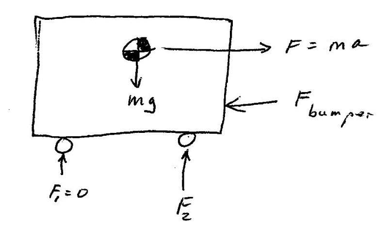

The machine on the cart is about 4.5 feet tall. If someone is moving it from the assembly department to the shipping department, I can see them accidently hitting something low on the ground. For example if they are going around a building column and cut it too close. They're usually pretty careful, but I can see an accident happening and I don't want the cart to fail catastrophically dumping the machine over and potentially landing on another person.
Tom.G said:
With the Center-Of-Gravity that far above the impact point at the wheels, load inertia will likely raise the rear wheels of the cart as the load keeps moving.
The cart with the load has a center of mass, and is supported by four wheels. Simplifying to a two dimensional problem results in a free body diagram as follows:
Since we want to know the acceleration that causes the rear wheels to raise, the force on those wheels is zero. Adding the necessary dimensions, and taking the sum of moments about the front wheels, we can calculate the acceleration. Knowing the velocity and acceleration, we calculate the stopping distance and force.
The next step is to go to a catalog of industrial shock absorbers, such as https://www.acecontrols.com/us/products/automation-control.html. There are other manufacturers, but this is the one that came to mind first. You will need to know the moving mass, the velocity, and the duty cycle. Shock absorbers are sized by kinetic energy, momentum, and energy dissipated per time.
Likes Tom.G, DTM and hutchphd
I like this analysis, and I can see if the rear of the cart did hop up, that would be one way of dissipating the kinetic energy over a longer period of time and lowering the impact load. However, the exact geometry of this cart/machine is actually lower than shown in the sketch and I think this is unlikely. I will do the analysis and find out though.
I do like the shock absorbers idea.
