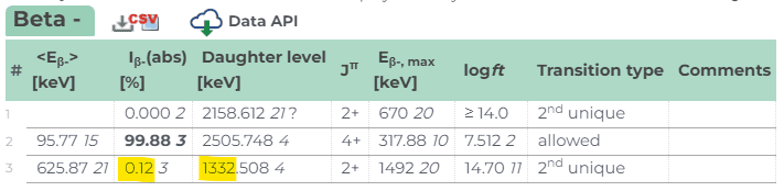

I was looking at the gamma radiation data from IAEA's website:
(https://www-nds.iaea.org/relnsd/vcharthtml/VChartHTML.html)
and was confused by the absolute intensity listed in the page. I Googled it and it seems to be the probability of emission but why it doesn't add up to 100%?
For example Cs-137 https://www-nds.iaea.org/relnsd/vcharthtml/VChartHTML.html
I don't understand why, because for example the sum of the beta intensities is 100%:
I know about gamma intensity related to the attenuation in matter but this is another topic
Thank you so much for your help

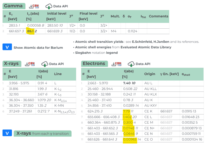

The 0.662 KeV state of Ba137 decays 85% of the time only by gamma emission and decays by the internal conversion process the rest of the time.
This would make sense and clarify the %, but how do you know it? I don't see this info in the website

Look under the heading "Electrons".
My fault, I wasn't considering the column of electrons and now I see them. My last question is: shouldn't these [%] (highlighted in yellow) make 100% (because it doesn't)?
(Excuse my ignorance, but what does the initials 'CE' mean (before the electron's shell)?
Keep in mind the percentages are the percentages of the radiation per decay. Cesium decays 5% of the time to the ground state of Ba which has no additional radiation processes. So only about 95% of the decays of Cs result in additional radiation so expect a gamma or an internal conversion electron 95% of the decays.

I think I got it now.
The percentages match as it should be right?
I've tried to make the same reasoning applied to Co-60.
I considered level 1332. You can reach it with the beta decay
, and with gamma decays
. Also without considering the conversion electrons the tot probability to reach final level 1332 (99,9776%) is lower than the probability of decaying from that level (99,9826%)
I've also tried to download the excel file with the whole data but there is still this incongruency... so I'm doubting I didn't understand the concept
