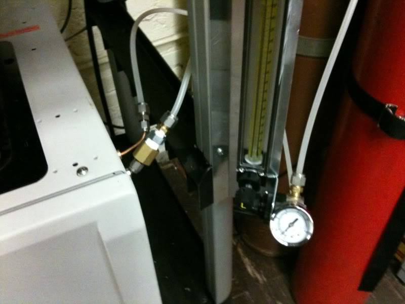

I use a miniature regulator to monitor the pressure of the incoming sample gas at the inlet and a rotameter to monitor the flow at the outlet. I have included at snapshot of the setup below.

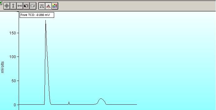

a) The way I have been instructed to do this (by someone who is only slightly more qualified than me) is inject a sample and take note of the retention times. I then put these retention times into the 'peak table' of the method along with the gas names and their respective percentages. I then run the method as 'type calibration'. I then run the method again as an analysis and the result is the following image:
As you can see, there is a small peak that should not be there (I think). The N2 is on the left and the CO2 to the right. I have run this method about 7-8 times in an attempt to 'flush out' whatever that peak is. The area counts for this peaks have dropped with each run but they are taking longer and longer to reduce now (we are around 3500 counts now). Moreover, my results are a bit off. It is reporting ~85% N2 and ~15% CO2 instead of 86/14 and I think that the stray peak is what is causing this.
So my major questions are:
1) Does my procedure for calibration seem reasonable? And more importantly, when I "take not of the retention times" I have simply been using the figure generated and putting the it in 'cursor mode' and hovering over the peak and writing down the times. But what time should I be recording? The time at the highest point of the peak? Or the time that the peak starts to form? Also, is there a more precise way of doing this?
2) What are your thoughts on the stray peak? Are there any common reasons I should start trouble shooting?

Image of gas inlet/outlet
