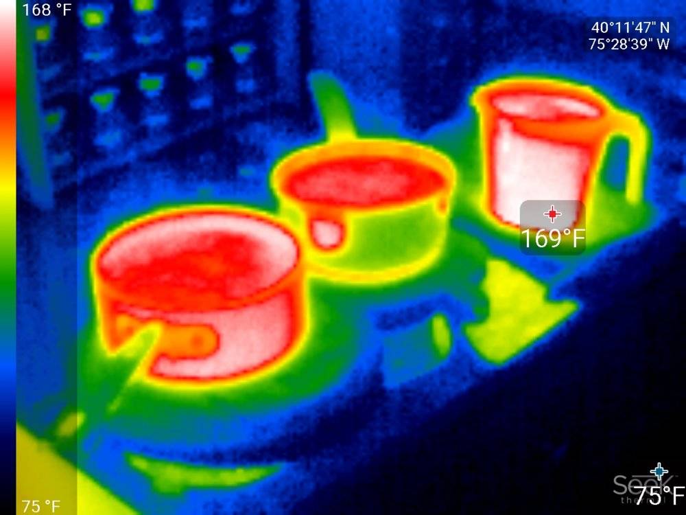

@wee VooDoo, if you're still around, I'd like to reiterate the above point. Here's a picture of three containers of boiling water that just came off a stove. It should be obvious which is stainless steel and why using an IR gun on a stainless steel pipe won't work.
