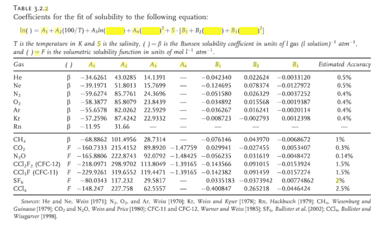

I can measure O2, Co2, TGP, and temperature, Want to calculate the rest gases, so N2, and Ar in my water.
There for i bulit up an axcel table. So i get to the point to calculate Bunsen contans on different Temperature.
I have this calculation:
ln(β)=exp(A1 + A2*(T/100) + A3*ln(T/100) + A4*(T/100) + S*(B1 + B2*(T/100) + B3*(T/100)^2
where β is in units of mL/L, and A# and B# are empirically derived least square fit constants, different for specifics gases.
Somehow, i wanted to find A1, A2, A3 and B1, B2, B3 constants for different Gases, but i don`t finde.
I need for O2, CO2 , N2, Ar the constants.
Can somebody help where to finde, or how to get it ?

There's a fat PDF here. Doesn't have all your coefficients but are you sure you need them all ? What's the application and what accuracy do you think you can achieve ?

So engineeringtoolbox.com i found before, but these are curves, and i cannot bild in a excel table. but Thanks Jim Mcnamara

So thanks for helping me, i show you what i mean
in the excel the first two tabel is important, the first is a calculator for the future
The second is the background
I made this, from M.B. Timmons /J.M.Ebeling Recirculating Aquaculture Book i found the calculations, and also the constants.
Where
Mf -(some times he use Xi ) mole fraction
Ki - Ratio of the molacular weight to volume
mg/mL
A1
A2
A3
A4 (he dosent use at all)
Ji -Dissolved gas concetration constant in liquid
And B - for salinity he odesn`t use and calcualte at all - that's what i want to build in
From that i can calculate the Busen coesfficient at different Temperature Tis in K, (so absolut)
β=exp(A1 + A2*(T/100) + A3*ln(T/100)
Pil=(Cmeas/β)*Ji

My problem is there, Argon is missing from the calculation, ewhats also 0.93%, so would be nice to have
i don`t finde A1, A2, A3 for Argon..or if i find, in the same table for known A1, A2, A3 is totally different (O2, CO2, N2) from Timmons given datas.
i want to bulid in the salinity, but somehow also totally different numbers and constants are given if i finde.
