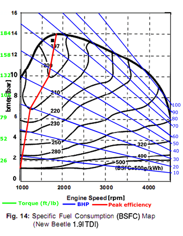

This is a BSFC map (one way of measuring engine efficiency) for a diesel engine:
For a constant rpm, the fuel consumption gets lower (better efficiency) as load (or torque) is increased.

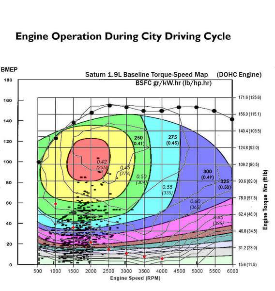

For a gasoline engine, maximum efficiency usually happens slightly before maximum load when at low rpm:

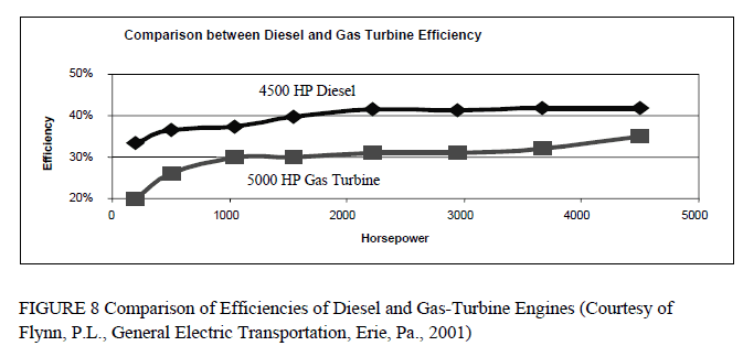

Furthermore, comparing diesel and gas turbine under part load:
The next graph shows the change of thermal efficiency of 5000 hp class diesel and gas turbine locomotive as a function of engine output power. This class of gas turbine is classified as middle size and it's part load efficiency is relatively good but still worse in comparison to diesel locomotive especially at low horsepower.
