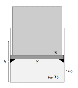

In the open cylindrical chamber is the piston of the total mass m. The initial air pressure inside the container is pa, the initial temperature T0. The initial height of the piston above the bottom h0. Now we start the gas supply heat to the moment when the piston reaches the height h above the bottom of the container .Air is ideal diatomic gas.
a / determine the final temperature T of the air inside the container
b / specify the total heat Q which air is received in the container
c / determine the efficiency of the piston stroke - ratio performed mechanical work and the total heat to the air inside the cylinder accepted

Is there vacuum outside the container? If so, then you have calculated the work correctly.
From a force balance on the piston, how is mg related to pa and S? Does the gas pressure change? What is the work in terms of pa, S, and Δh? What is the initial volume in terms of h0 and S? What is the final volume in terms of h and S? From the ideal gas law, what is the final temperature in terms of h, h0, T0?
yes, there occurs heat exchange, I understand...no vacuum, out is atmospheric pressure...
the initial volume V0 = S*h0
the final volume V = S*h
so answer a/ V/V0 = T/T0...T = T0*h/h0

This is on the right track. But, if there is air outside then the work you calculated is not correct. From a force balance on the piston, $$P_aS=P_0S+mg$$where ##P_a## is the gas pressure and ##P_0## is the outside pressure. So the work the gas does on the piston is $$W=P_aS(h-h_0)=(P_0S+mg)(h-h_0)$$
Also, for a diatomic gas, the change in internal energy should be $$\Delta U=\frac{5}{2}nR(T-T_0)$$

But I have a problem, I do not know molar amount n, I can not therefore calculate ΔU :-(
Really? I think you have enough information to determine n. What do you think?
Can I express it from the initial state?
pa * S * h0 = nRTo... n = (pa * V0)/R *T 0

Q = W + ΔU = (p0S + mg ) ( h-h0 ) + 5/2 R ( T-T0) * ( (p0Sh0)/RT0 )
The ##\Delta U## should have pa=p0, not p0. And, in that term, you should eliminate T and T0. Also, in the W term, you should use paS in place of (p0S + mg ).
