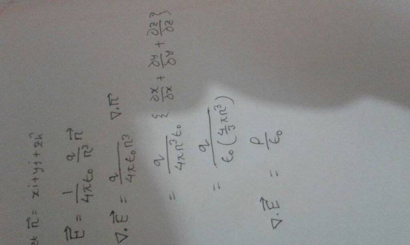

hmmm i have derived a proof.. but don't know if its ok :/
btw it would be great if u could explain this "sum of divergence of the electric field throughout the volume is sum of the flux through the surfaces " with some animation or something. i know they will be the same but having trouble visualizing this. @jtbell
I can see problems with it. Firstly, the divergence operator can't pass through the ##\frac{1}{r^3}## factor without justification, as ##r## depends on ##x, y, z##. Secondly, it's not clear what the role of ##r## is, as there are no words explaining the meaning of the various variables. ##\vec{r}## appears intended to be a location vector, but the location of what, relative to what?
It looks to me as though in the last step you may be essentially paralleling the Divergence Theorem, which is what's used to get from the integral form to the differential form.
The most natural way to prove Gauss's Law, it seems to me, is to use Coulomb's Law to prove the Integral Form of Gauss's Law and then use the Divergence theorem to prove the Differential Form from that.
If you don't want to go that way, I think you will have to come to terms with the Dirac Delta, because the charge is supposed to reside in a zero-dimensional point, which is exactly the sort of thing Dirac Delta is designed to cope with. The sifting property referred to in the proof is simply that, if ##a\leq c\leq b##, then:
$$\int_a^b f(x)\delta(x-c)dx=f(c)$$
