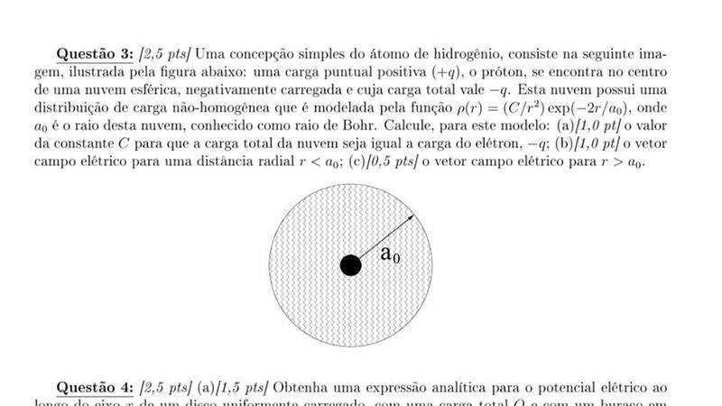

Suppose the hydrogen atom consists of a positive point charge (+e), located in the center of the atom, which is surrounded by a negative charge (-e), distributed in the space around it.
The space distribution of the negative charge changes according to the law p=Ce^(−2r/R), where C is a constant, r is the distance from the center of the atom, and R is Bohr's radius.
Find the value of the constant C by using the electrical neutrality of the atom.
Find the electrical field for r<R
Find the eltrical field for r > R
So what I've done is:
Since p stands for charge density, p = Q/V , where V = 4/3 Pi R^3 and Q = -Q
Thus, p = C*exp^(−2r/R) = -Q / 4/3 Pi R^3
Solving for C... C=[ -3*Q* r^2 * exp(2R/r)] / 4*Pi* R^3
For the electrical field I couldn't think of anything...
Sorry for the portuguese image... It was the only I could find. Note Ao = R

Your equation for finding the charge assumes uniform charge density. The density is not uniform, so you will have to do an integral. For the electric field you need to use Gauss's Law.

But if I integrate considering Q = ∫ ρ dV
Considering a Gaussian Surface with thickness of dr' ; the volume would be 4 * pi * r' * dr'
Where dV = 4 Pi r' dr' ... integrating from 0 to R I will get the same result as before.
Not quite.
$$Q=\int{\rho(r) dV}=\int{\frac{C}{r^2}~e^{-\frac{2r}{a_0}}dV}$$
What is ##dV## in spherical coordinates?
Also, for future reference please use the homework template when posting homework problems or your post may be deleted.
