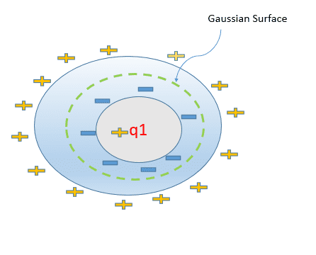

I have drawn a diagram to understand, the q1 = 3uC. If we consider the gaussian surface the Flux is zero
∅ = 0; ∈0*∅ = q_enclosed;
q_enclosed = 0;
Let the charge on the cavity is q_cavity;
q_cavity + q1 = 0;
q_cavity = -3uC
This i understood. The confusion is for the net charge let us say q_net.
The same principle i apply ∅ = 0;
The charge on the surface is q_surface;
q_surface + qnet +q_cavity+q1 = 0;
q_surface = -qnet; = -10uC; The answer is wrong and i am completely wrong, where i am making the mistake. Please advise.
Physicslearner500039 said:
q_cavity = -3uC
Correct.
The conductor charge is +10 ##\mu##C.
What is left of the conductor charge is sitting on the outside of the conductor. How much is that if you subtract the -3 ##\mu##C from the original +10 ##\mu##C ?
