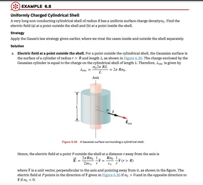

A very long non-conducting cylindrical shell of radius R has a uniform surface charge density ##\sigma##. Find the electric field at a point outside the shell.
##\frac{R\sigma}{\epsilon_0*r}##
I am confused why we don't take into account the lids of the cylinder since the Gaussian cylinder is of finite height L as shown in the image

Of course we take into account the lids. What is the electric flux through each lid?

The actual solution did not take into account the lids.
Can you post the actual solution as was given to you? Maybe it explains what to do about the lids and you missed it. Alternatively, calculate the flux through the lids and see what you get. Maybe you don't need to worry about the lids.
kuruman said:
Can you post the actual solution as was given to you? Alternatively, calculate the flux through the lids and see what you get. Maybe you don't need to worry about the lids.

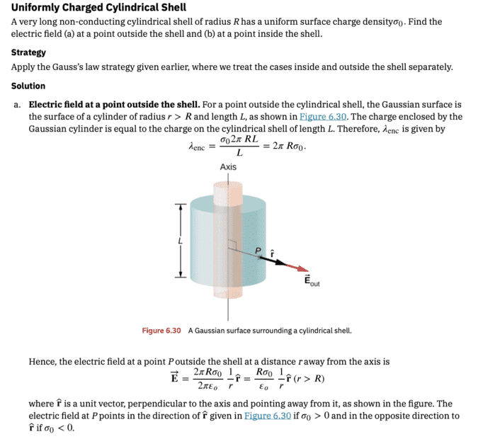

It is alternatively here: https://opentextbc.ca/universityphysicsv2openstax/chapter/applying-gausss-law/
OK, they don't mention the lids. I hd to make sure. So what do you think the electric flux is through the lids? What do you have to know to calculate it?

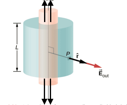

How can the electric field just be radial when the Gaussian cylinder is of finite length L. Because the Gaussian surface has finite length, there should be electric field from the lids.

No. This is not what Gauss’ law says. Gauss’ law states that the flux of the electric field through a closed surface is equal to the enclosed charge divided by epsilon_0. This is equal to EA only of the electric field is perpendicular to the surface and has the same magnitude on the entire surface.
The field’s value does not depend on whatever Gaussian surface you choose to draw. In the case of the infinite line charge, the reflection symmetry around any plane perpendicular to the line means the field can have no component in the direction of the line. The reflection symmetry through a plane containing the line and the point where you want to know the field implies there can be no tangential component of the field.

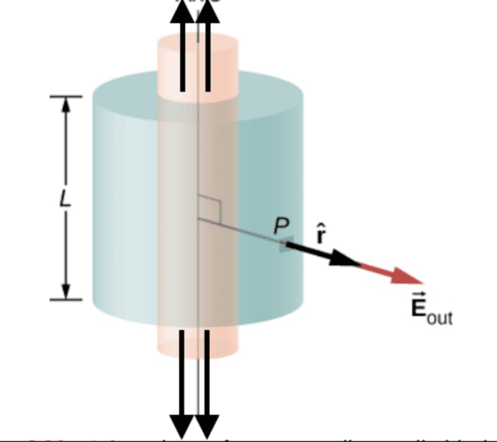

I am not saying that at the lids the electric field is parallel to the lid. The black arrows are what I am suggesting.

Please reread my post. By the symmetries of the line charge, the electric field can have no component in any direction other than the radial direction. This means that the field is parallel to the lid, which is why it is a problem that you are not saying that it is.

Rereading this thread you seem to be under a very serious and fatal misconception that the Gaussian surface you draw somehow affects the field. It does not. The field is generated by the infinitely long line charge and the Gaussian surface has nothing to do with it. The Gaussian surface is a tool to use to help you figure out what the field generated by the line charge is by cleverly selecting what surface to use, but it carries no charge in itself and does not carry any charge. It encloses part of the charge that is carried by the line, but that is a different issue and just relates to the flux of the field out of the surface.
