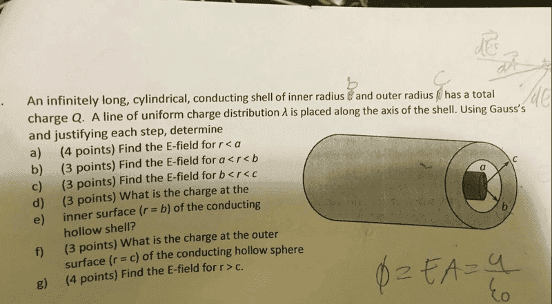

An infinitely long, cylindrical, conducting shell of inner radius b and outer radius c has a total charge Q. A line of uniform charge distribution Λ is placed along the axis of the shell. Using Gauss's Law and justifying each step, determine. A) The Electric Field for r>a, B)The Electric Field for a<r<b, C) Find the Electric Field for b<r<c D) What is the charge at the inner surface ( r = b ) of the conducting hollow shell? E) What is the charge at the outer surface (r=c) of the conducting hollow sphere? F) Find the Electric Field for r > c

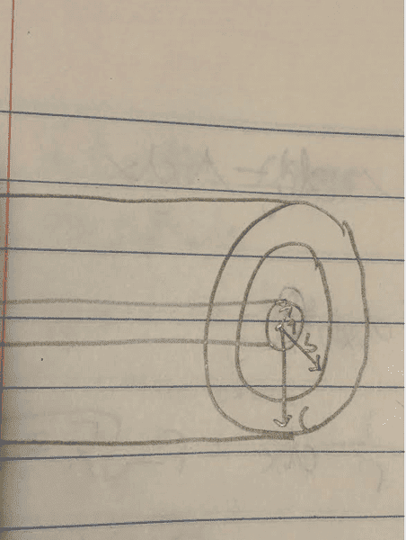

This is what I have so far, in regards to an actual drawing of it, I believe we would take our radius as a
You do not want to choose the radius of the Gaussian surface to be ##a##. You are trying to find the electric field at a particular distance ##r## from the center where ##r <a##.
Was a picture provided with the statement of the problem?
Here is the original picture and question, I found the original diagram a little more confusing.
