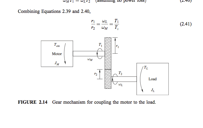

A vehicle having wheels with a diameter of 58cm, is powered by motors that have a maximum speed of 6024 rpm. Each motor is coupled to the wheel using a gear mechanism as shown in figure 2-14. Calculate the required gear ratio if the vehicle's maximum speed is 190.2 km/hr.
Note: Answer is a unitless value, correct upto two decimals.
No clue. C = 2 * PI * R?
I converted 6024 rpm to radians per second hoping I could do the same with hm/hr, but I do not know the radius of the tire? See photo attache for diagram. Thanks for help.

... but you know the diameter of the wheel. How is diameter related to radius?...
I converted 6024 rpm to radians per second...
I would start "at the other end of the problem". eg Work out the rpm of the wheel at max velocity.
