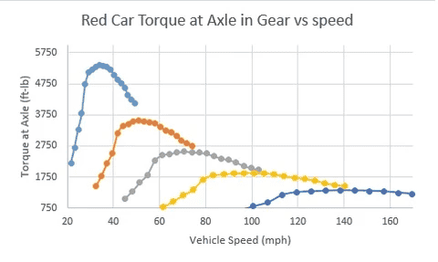

Maybe see if this website helps with your problem. It's looking at shift points from a practical point of view, using dynomometer measurements to back it all up. Maybe it will give you some insights into the way that you want to try to do this with calculations...
https://www.evodynamics.com/blogs/news/114447365-calculating-shift-points
Likes FactChecker and Tom.G
From that nice graph that @berkeman found, it looks like the shift point is at or just before the intersection of the curves for adjacent gears.
Given that, subtract the equations of two adjacent gears and solve to find where they intersect.
f (1stGear) - f (2ndGear) = 0
The OP does not specify how the gear ratios were determined. From the example graph, it looks as though the shift point might be the RPM redline, which might be before the torque curves intersect. I suspect that will be true for any well-designed transmission gear ratios. Certainly that is true for the low gears of any motorcycle that I have ridden. I guess that the design of the upper gear ratios might be influenced by the typical highway cruising speed.
