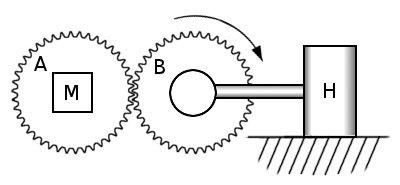

And I have a follow-up question concerning torque translating to linear force. Let's say there's load in the form of a hammer H connected to gear B, and this strikes another object:
At the point of impact, I need to know the momentum of the hammer head in order to resolve the collision. I presume the linear velocity of the hammer head could be calculated by [tex]v = r\omega[/tex], where [tex]r[/tex] is the length of the hammer and [tex]\omega[/tex] is the angular velocity of gear B. But what about the mass? Would this include the mass of the gears?
Then let's say the hammer remains in contact with the object. As far as I understand, the contact force would calculated by [tex]F = \frac{\tau}{r}[/tex] where [tex]\tau[/tex] is the torque at gear B. Is this correct?
At the point of impact, I need to know the momentum of the hammer head in order to resolve the collision. I presume the linear velocity of the hammer head could be calculated by , where is the length of the hammer and is the angular velocity of gear B. But what about the mass? Would this include the mass of the gears?
Then let's say the hammer remains in contact with the object. As far as I understand, the contact force would calculated by where is the torque at gear B. Is this correct?
No, in case of momentum of hammer it won't include mass of gears. You only need to know mass of the hammer itself.
And for contact force I think you are correct but I'm not that sure here!
This is correct. In that case there is no motion so power is zero. So the proper balance equation is the force balance equation: FA = FB, where FA is the force acting on the teeth at gear A and FB is the opposing force acting on the teeth at gear B. Each force multiply by its respective radius gives the gear torque. TA being the torque produced by the motor and TB being the torque applied by your hammer (as you calculated it).
The problem here is more complex as the impact force depends a lot on material property (how they will deform under impact). This deformation will give you a distance "traveled" by the hammer to achieve a complete stop and, knowing the initial velocity (as you stated, [tex]v = r\omega[/tex]), will give you the deceleration rate of the hammer AND gear set. So inertia of the gears are also important.
I think the force applied by hammer will not come alone from the torque at gear B. Here gravity will also play it's role. If W is weight of hammer then torque at B will be increased by an amount= (W x length of hammer).
You're correct of course, but for my purposes I can disregard gravity.

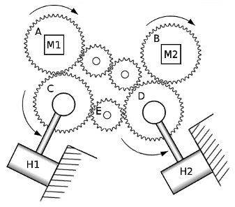

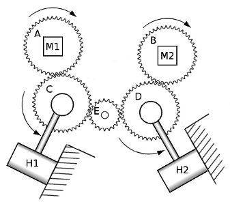

This makes sense. So, where are the forces acting when we have more than one motor and more than one hammer? For example:
Obviously here motor M1 applies a force to the object H1 is in contact with, via gears A and C, and motor M2 applies a force to the object H2 is in contact with, via gears B and D. But does M1 also affect H2, and M2 affect H1 via gear E? If so, how much force does each motor apply to each hammer? Does half of gear C's torque apply to H1 and half to gear E? And would M1 apply a force to M2 and vice versa?
If M1 does not affect H2 and M2 does not affect H1, then what about if these gears are added:
I think I'm having trouble tracing where forces are acting. It seems to me that the arrangement of the gears would be important in these cases, but I could be wrong.
The important relationship to understand with gears is that at the contact point between 2 gears the forces acting on the tooth of each gear are the same and the linear velocities of each tooth are also the same. From there, you can find torque and angular velocity for each gear.
The problem with the gear set presented above is that they contain redundant gears, meaning that power transmission can take one path or another. When there is symmetry, you can divide the force equally between the paths. For example, in this case:
only one idler gear is necessary. The other one is only there to "pull" on the first one such that it doesn't fall. But if there was a shaft welded to cylinder block, the second gear would be unnecessary.
In real life, in such system, the power can be transmitted through one path only due to manufacturing tolerances; the other gears would become simple idlers because they would be "loose". So as far as how much torque goes through which gear set, all answers can be true in a redundant mechanism.
For example, to be stable a table needs only 3 legs; the fourth one is redundant and may have no weight at all resting on it. If tolerances are good and the floor is perfectly flat, you can assume that each leg supports 1 quarter of the weight because of symmetry. But add a fifth leg randomly and your guess becomes as good as mine.
So assuming we have an ideal, perfectly manufactured gear set, the force each gear delivers to connected gears would be split equally? So in the 7-gear diagram, the torque at gear A, [tex]\tau_{A}[/tex] would translate to contact forces with C and the smaller gear, each of [tex]\frac{1}{2}\frac{\tau_{A}}{r}[/tex]. Tracing the forces from A and B around all the paths, I end up with [tex]\frac{1}{4}\frac{\tau_{A}}{r} + \frac{2}{3}\frac{\tau_{B}}{r}[/tex] at H1 and [tex]\frac{3}{4}\frac{\tau_{A}}{r} + \frac{1}{3}\frac{\tau_{B}}{r}[/tex] at H2. Have I calculated that correctly?

[tex]
\frac{\tau_{1} - I_{1} \alpha_{1}}{r_{1}} = \frac{\tau_{2} - I_{2} \alpha_{2}}{r_{2}}
[/tex]
[tex]
\alpha_{1} r_{1} = - \alpha_{2} r_{2}
[/tex]
If you solved those equations you get:
[tex]
\tau_{1} - \left( \frac{r_{1}}{r_{2}} \right) \tau_{2} = \left[ I_{1} + \left( \frac{r_{1}}{r_{2}} \right) ^{2} I_{2} \right] \alpha_{1}
[/tex]
Or:
[tex]
\tau_{eq} = I_{eq} \alpha_{1}
[/tex]
Where [tex]\tau_{eq}[/tex] and [tex]I_{eq}[/tex] are the equivalent torque and inertia of the 2 gears that need to be accelerated, based on the acceleration of gear 1.
If you assume that a motor is on gear 1 and nothing on gear 2, then [tex]\tau_{1}[/tex] is the torque of the motor and [tex]\tau_{2} = 0[/tex] since there is no exterior input or output torque. So:
[tex]
\tau_{1} = \left[ I_{1} + \left( \frac{r_{1}}{r_{2}} \right) ^{2} I_{2} \right] \alpha_{1}
[/tex]
If there was a torque applied at gear 2 then it would be added to (or subtracted from) the torque of gear 1. For example if we assume that clockwise direction is positive and that [tex]\tau_{1}[/tex] is positive, then a motor putting a counterclockwise torque (negative) on gear 2 would increase the total torque. If it was a clockwise torque (positive), it would work against the motor at gear 1, hence the subtraction.
If [tex]\tau_{eq}[/tex] is zero, then [tex]\alpha_{1}[/tex] must be zero, meaning the gear set is turning at a constant rpm.
If you have more gears, you will still end up with an equation of the form [tex]\tau_{eq} = I_{eq} \alpha_{1}[/tex]. For the 3-gear example you did not solve the equation with [tex]\tau_{2}[/tex] and [tex]\tau_{3}[/tex] which will give [tex]\tau_{2}[/tex] as a function of [tex]\alpha_{1}[/tex] (since [tex]\tau_{3} = 0[/tex]).
As for the 5-gear setup, you won't have to assume anything if you know the torque of M1 and M2, because there are no redundant path. For example, if M1 has sufficient torque for the acceleration of gear A, C, H1 and half of E and M2 has sufficient torque for the acceleration of gear B, D, H2 and half of E, there will be no torque transfer from on side to the other. But if it is not the case (assume torque at M2 is zero), then some torque of M1 will have to through gear E to accelerate gear B, D and H2.

You're right, there is something wrong, I'm trying to go too fast. Let's start again.
Assumption: 3-gear set; All torque applications and all gear rotations are clockwise.
For gear 1:
[tex]\frac{\tau_{1} - I_{1} \alpha_{1}}{r_{1}} = F_{12}[/tex]
Where [tex]F_{12}[/tex] is the force common to gear 1 and 2.
For gear 2:
[tex]\frac{\tau_{2} - I_{2} \alpha_{2}}{r_{2}} = F_{12} + F_{23}[/tex]
For gear 3:
[tex]\frac{\tau_{3} - I_{3} \alpha_{3}}{r_{3}} = F_{23}[/tex]
Opposite and equal acceleration for gear 1 and 2:
[tex]\alpha_{1} r_{1} = - \alpha_{2} r_{2}[/tex]
Opposite and equal acceleration for gear 2 and 3:
[tex]\alpha_{3} r_{3} = - \alpha_{2} r_{2}[/tex]
So 5 equations, 5 unknowns ([tex]\alpha_{1}[/tex], [tex]\alpha_{2}[/tex], [tex]\alpha_{3}[/tex], [tex]F_{12}[/tex], [tex]F_{23}[/tex]). Solving:
[tex]\frac{\tau_{2} - I_{2} \alpha_{2}}{r_{2}} = \frac{\tau_{1} - I_{1} \alpha_{1}}{r_{1}} + \frac{\tau_{3} - I_{3} \alpha_{3}}{r_{3}}[/tex]
Replacing [tex]\alpha_{2}[/tex] and [tex]\alpha_{3}[/tex] with [tex]\alpha_{1}[/tex]:
[tex]\frac{\tau_{2} + I_{2} \alpha_{1} \frac{r_{1}}{r_{2}}}{r_{2}} = \frac{\tau_{1} - I_{1} \alpha_{1}}{r_{1}} + \frac{\tau_{3} - I_{3} \alpha_{1} \frac{r_{1}}{r_{3}}}{r_{3}}[/tex]
Rewriting:
[tex]\tau_{1} - \tau_{2} \frac{r_{1}}{r_{2}} + \tau_{3} \frac{r_{1}}{r_{3}} = \left[ I_{1} + \left( \frac{r_{1}}{r_{2}} \right) ^{2} I_{2} + \left( \frac{r_{1}}{r_{3}} \right) ^{2} I_{3} \right] \alpha_{1}[/tex]
Or:
Note that [tex]\tau_{2}[/tex] is subtracted because we assumed it was applied clockwise, just like for gear 1 and 3; Though the rotation is opposite. But all the inertia terms are additive. If [tex]\tau_{2} = \tau_{3} = 0[/tex] then [tex]\tau_{eq} = \tau_{1}[/tex].
