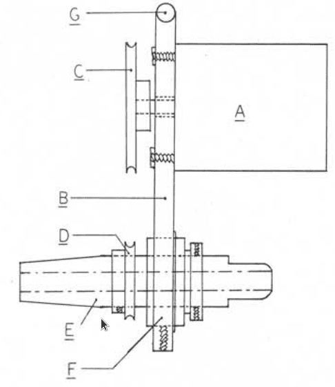

I have attached the design I am essentially following. The picture is a top-down view.
design
A is the motor
B is the wooden support with a bearing slot bored and glued into place(ignore the screw coming in from the bottom to the rod, the bearing will be epoxied into place)
C is the pulley mounted to the motor 2" in outer-diameter
D is the pulley 3" in outer diameter 1" in inner diameter that will have a set-screw holding it to the teflon rod
E is the teflon rod
F is the bearing
As you can see on the back of the teflon rod is seated another bearing to keep the rotor from sliding. Before the pulley(viewing left-to-right) you will notice another similar device, however I will be using a bearing with a key-slot to directly fix it to the rod instead.
The entire assembly will be seated at a slight angle pitching the cone shaped end of the rod slightly down-ward by perhaps 15*.
The teflon rod will support a glass-flask filled partially with various fluids so the load will vary a bit. The design is for a low-tech low-cost rotary evaporator for those familiar with chemistry. My brother is at school to become a watch-maker and I believe he has access to a lathe.

Which I believe I can use spacers to fix directly to the motor shaft and use a 1" bore pulley directly for the teflon rod. So that is finally solved.

It says it has a torque of 90 N cm which is PLENTY. The design I am borrowing says to use 30 oz in which is about 21.2 N cm. However it does not mention stall-torque or stall-amperage? There is another similar 12V motor running 120 RPM with 60 N cm of torque. Not sure which would be better.. It's no help that I am a complete bozo when it comes to electronics :D. I estimate the load it will have to rotate will be around 1kg-4kg and ideally I want the shaft to be able to rotate at around 50RPM's (+/-)10RPMs a little more or less is completely fine. However I have no idea how much the carved teflon shaft will weigh, or the pulley weight. If this motor probably won't work please let me know. Keep in mind teflon has one of the lowest coefficients of friction for known materials and the teflon rod will be seated in a teflon bearing with silicone greese. So friction of the rotor is not an issue in my eyes.
However at 100rpm with a pulley ratio of ~3in OD to ~2in OD it should run at about 66 RPM's(which hopefully won't be drastically effected by the load). Which hopefully potentiometer will allow for speed adjustment without straining the gears in the motor(knowing china they are plastic).

Gear motors have mechanical reduction built in so the whole thing mounts as one piece. Good call pantaz. That defiantly simplifies things, in addition to probably lowering your cost and reducing the size and foot print of your project.
well I have ordered the gear motor I linked too under the components section of one of my previous posts. 90N cm will hopefully be enough to drive this thing according to an online calculator it should in theory be able to generate a force of about 9N-10N.The teflon, bearings and such are still awaiting shipment.
