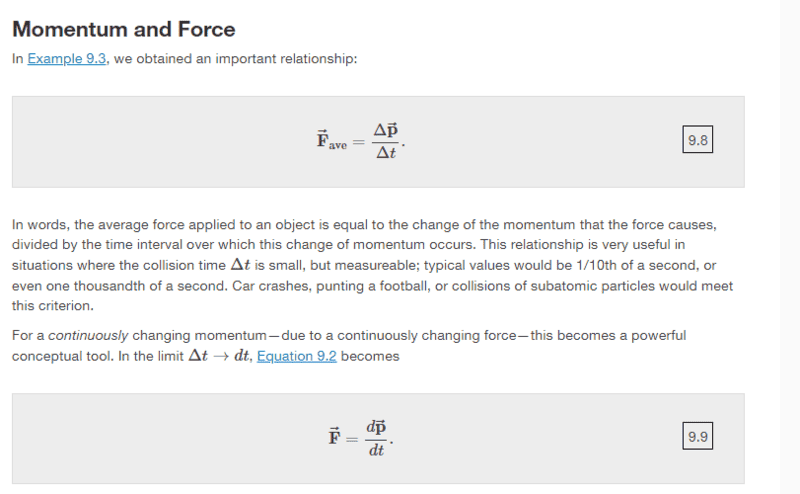

For this,
Does someone please know how do we derive equation 9.9 from 9.8? Do we take the limits as t approach's zero for both sides? Why not take limit as momentum goes to zero?
Many thanks!

Are you going from 9.9 to 9.8 or from 9.8 to 9.9?
9.8 to 9.9:
When you define
##y^{\prime}(x) \approx \dfrac{ \Delta y}{ \Delta x}##
which variable do we take the limit of as we pass to the exact definition?
9.9 to 9.8:
This is a definition of one way to approximate the derivative.
-Dan
Likes member 731016
ChiralSuperfields said:
Homework Statement: Please see below
Relevant Equations: Please see below
It is standard differential calculus. If the momentum function is differentiable then, necessarily, as ##dt\rightarrow 0## ##d\vec p\rightarrow 0##. The converse is not necessarily true.
Since ##dt\geq 0##, the limit is taken from above.
Likes topsquark and member 731016
For a derivative to exist, the two sided limit must exist. The limit is taken from both sides. ##dt## may be negative.
There is often a prejudice toward the future. Predictions for past behavior are less useful. We want to know what will happen next. But it is just a prejudice, not something inherent in the definitions.
Likes member 731016, DaveE and nasu

Thank you for your replies @topsquark, @haruspex and @jbriggs444 !
@topsquark You are correct, I was curious in going from equation 9.8 to 9.9.
According to calculus textbooks we take the limit as ##\Delta x## approach's zero. However, why can't we take the limit as ##\Delta y## approach's zero because as ##\Delta y## goes to zero so dose ##\Delta x## correct?
Many thanks!
No. As I wrote:
Consider a quartic with local minima at ##x=\pm 1, y=1##. If we start with ##(x,y)=(-1,1), \Delta x=2.1,\Delta y=0.1##, say, then as ##\Delta y\rightarrow 0##, ##\Delta x\rightarrow 2##.
The key point is that ##y=f(x)## does not necessarily have a unique inverse function ##x=f^{-1}(y)##.
Likes member 731016, topsquark and hutchphd
