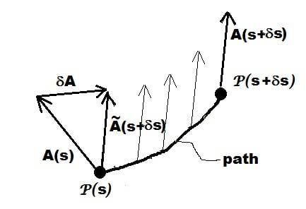

Oh, I didn't actually describe the procedure, I just gave the equation. The procedure is this, in a little more detail:
  1. Start with a parametrized path [itex]\mathcal{P}(s)[/itex].
  2. Let [itex]A(s)[/itex] be an arbitrary 4-vector that is defined along the path [itex]\mathcal{P}(s)[/itex]
  3. Let [itex]\tilde{A}(s + \delta s)[/itex] be the result of parallel-transporting [itex]V(s + \delta s)[/itex] back along the path [itex]\mathcal{P}[/itex] from the point [itex]\mathcal{P}(s + \delta s)[/itex] to the point [itex]\mathcal{P}(s)[/itex]
  4. Let [itex]\delta A = \tilde{A}(s+\delta s) - A[/itex]
  5. Then [itex]\dfrac{D}{Ds} A = {lim}(\delta s \rightarrow 0) \dfrac{\delta A}{\delta s}[/itex]
