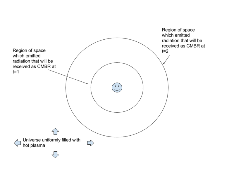

It looks to me like you're thinking of the big bang as matter and radiation escaping from a single point. The standard cosmological models are homogeneous and isotropic (on large enough scales). What it means, is they treat the universe as either infinite or finite and closed (similar to the surface of a sphere), with matter and radiation spread uniformly throughout the volume. You arrive at the big bang = hot and dense state, when you make all distances shrink sufficiently.
In such an universe you receive CMBR once emitted from ever further regions of space, centred around the observer.
A picture is worth a thousand words, as they say:
JulienB said:
2. The shape of the CMB map we have is spherical. Did that observation come from observing the sky in all directions? Can we approximate the size of the sphere at the time when the light could escape? Can we say "where" the Big Bang happened, relatively to the position of the galaxies today? Is the last question senseful? :)
As seen above, the spherical shape of CMBR comes from the fact that you're receiving radiation emitted from around you. You can't say where BB happened, since there was no centre. Alternatively, it happened everywhere.
