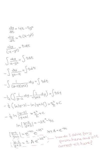

Find the general solution of the differential equation y'=4t-ty^2
y'=4t-ty^2
I 'think' this question is pretty straight forward but I'm still not sure if I did it right or not. I have two question. One till the last step that I have done, have I done it correctly 2. How do I proceed from there? The attempt is attached.

What you've written is correct. Normally, you should know on what subset of R you're looking for y. If not, then keep the modulus there and don't explicitate.
The proff didn't give any range for y. So by don't explicitate you mean I should keep it the way it is?
Yes.
