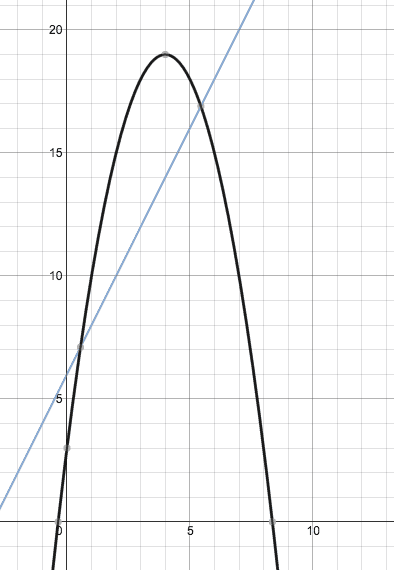

Make a simple google graph to see the shapes.
Both of these sets of functions are allowed in the constraints of this question.

Function 1: 6x^2 - 2x + 8
Function 2: 4x + 8
This problem represented by the second graph.

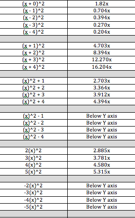

  • #32
I've carried out some investigations involving altering values of the quadratic then change the gradient of the line to get an area of 1.
I think all the combinations of the quadratic can fit into the investigations carried out in that table. I haven't really seen any patterns though...
