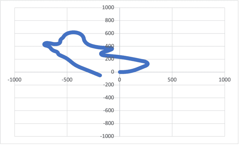

I hope you are all great. I am writing down to all of you concerning a problem of mine. I am struggling to generate a trackmap based on Speed (m/s) and G-Forces on excel.
I followed a topic created 12 years ago but unfortunately it is closed :
https://www.physicsforums.com/threads/draw-map-based-on-speed-and-g-forces.518628/
Attached you will find my row data, there is just the beginning of the lap to minimize the file's size, I would be so happy to get some explanations, we never learn enough :-)
Thank you very much!
  • analyse-trackmap.xlsx

In your Excel spreadsheet:
  • You are missing the time interval between each measurement;
  • Are you sure the lateral acceleration is in m/s²?
  • dA doesn't include the multiplication with the time interval;
  • Vx & Vy have the wrong angle (they all have 1 rad or 89 rad);
  • X & Y do not include the multiplication with the time interval either;
  • X & Y have the velocity Vx & Vy multiplied by sine and cosine and they shouldn't;
  • Might be better if X0 & Y0 both equal zero;
  • Your graphs are linked to external data.
Because of the large values for R, this looks like a vehicle going in a straight line.

After working today on it, I feel I am not too far away from the right result.
The thing is, I don't know how to figure Ao out. As I don't know Ao and A, I can't solve the equation. I feel like I am stuck.
Is there another way round to know my Ao ? As normally i should be able to draw a trackmap from G forces and Speed I guess there is something I don't get here

A is the angle of the car with respect to your X-Y plot. It is not the steering angle.
A0 is the initial value.
A1 = A0 + dA0
A2 = A1 + dA1
A3 = A2 + dA2
The same concept goes for X and Y.

Jack,
Big big thanks for your crucial help. I manage to finish the tool I wanted to do.
You are a genius!
See you soon!

Can you post the final version of your spreadsheet? Also, can there be a correction factor applied to lateral G to join the ends of the plot? I assume these are the same position on the track (start/finish)... I recall about 25 years ago, PI datalogging software would automatically do this to represent a track map.
I also notice that your plot is a mirror image of the actual Pau track. Again can this simply be corrected by multiplying Lateral G by -1?
