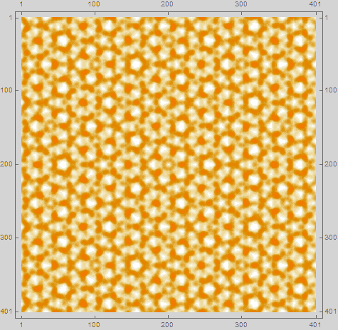

For some reason, using a clipped Sine function seems to work:
Anyone know why? A regular sine function just creates the double symmetry problem again.
Code:
xmin = -10;
xmax = 10;
ymin = -10;
ymax = 10;
rez = 400;
sym = 5;
v = 2*Pi*(Sin[i*2*Pi]*x + Cos[i*2*Pi]*y);
Sinu = Max[Sin[ v], 0];
P = Sum[Sinu, {i, 0, (sym - 1)/sym, 1/sym}];
MatrixPlot[ Table[N[P], {x, xmin, xmax, (xmax - xmin)/rez}, {y, ymin,   ymax, (ymax - ymin)/rez}]]
