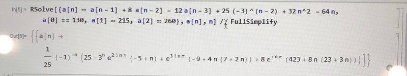

Thanks for pointing out. I have used Mathematica and typed straight in a[n] and solve it with boundary conditions and it gave me the answer include exponential which i have not seen along the way finding its solution including particular solutions . Have you seen something like that in Maple?
And yeah i did have mistakes, i have checked it, and even when i corrected it it also does not give me any exponential term :(

Oops: I see I had a wrong recursion; I wrote -64 instead of -64n on the right. I will do it again.
Attached is the new worksheet.
I forgot to simplify the result, but when I ask Maple to do that it gives
$$a_k =(-1)^k 3^k k+5(-1)^{k+1} 3^k+8k^2+60k+135.$$
This looks different from the Mathematica result, but I have checked it out in detail: it really does solve the recursion. (I got Maple to check this after making the pdf file, so that check is not included in the attachment.)
