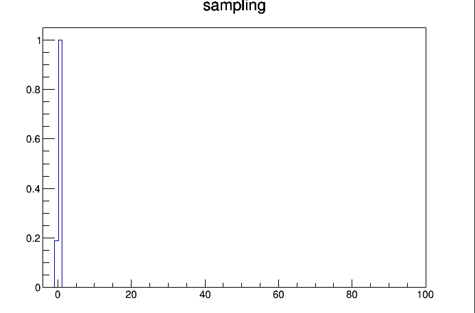

So this is what I get when I run n from 0 to 10000. Obviously, this doesn't look right.
If you examine the sample mean, you might see a very slight bias toward the high side since your range of x cuts off more of the lower tail end than the upper.

What is your x-axis here? Your accepted x-values will cluster tightly around 0.3, so I don't think that this histogram is usable. But setting the parameters of the histogram is a ROOT plotting issue, not a random number issue. I see no reason to doubt your rejection method just because of the unusable histogram.

I don't know what you mean by 1D and 2D, two dimensional? The problems with the histogram are the range of the x values and the lack of fine resolution on the x axis.
Your line:
TH1D *dist = new TH1D("dist", "sampling", 100, -4, 100);
is specifying 100 bins from x=-4 to x=100.

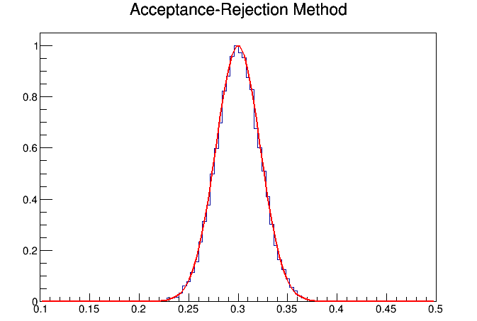

But x only goes from 0 to 1, and much of that range has very small probability. Look at the graph in post #8. Better parameters would be 100, 0.1, 0.5:
TH1D *dist = new TH1D("dist", "sampling", 100, 0.1, 0.5);
When you plot a PDF, remember that the integral is 1 (not the maximum). So you need to know how many total samples were accepted (not rejected) and divide the histogram bin numbers by that total number.
You want a one dimensional histogram (only x is variable) - but as FactChecker wrote the binning is wrong. All your entries are in just one or two bins.

if(y <= f->Eval(x))
This works. After fixing the binning, the redefinition of scale and this point I get a graph that looks reasonable given the small n=100. With n=10000 it resembles a Gauss shape.

Alright, I got it. Thanks for the help, everyone.
