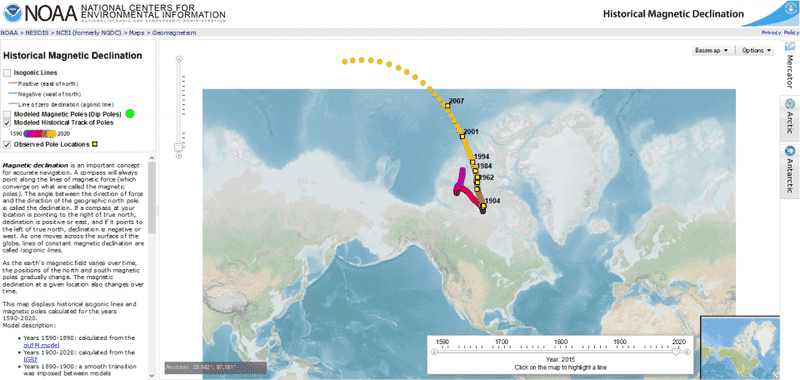

Geomagnetic excursion. Please open the link for another diagram and text.
https://www.facebook.com/photo.php?fbid=773979662703490&set=p.773979662703490&type=3&theater&viewas=100000686899395 https://www.facebook.com/photo.php?fbid=773979149370208&set=p.773979149370208&type=3&theater
