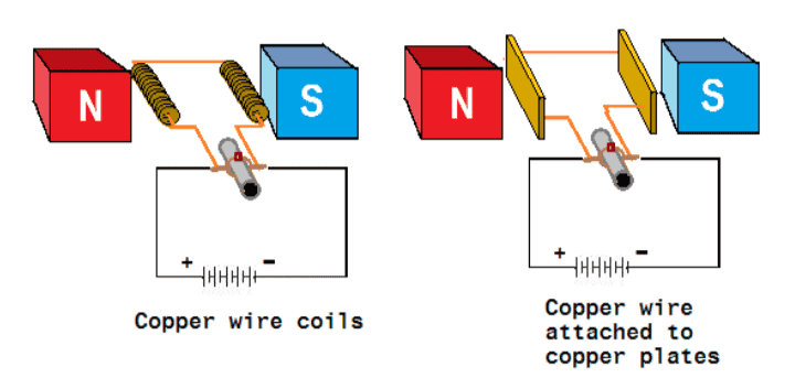

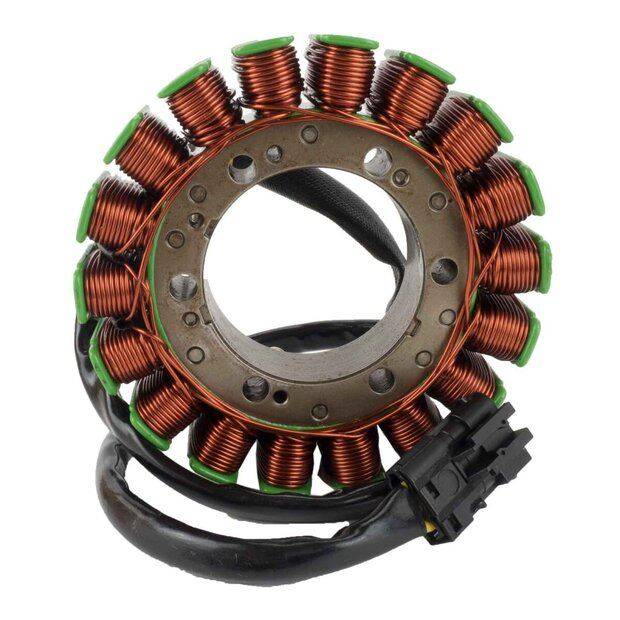

Inside a electric generator. To produce the most electricity catching the greatest number of electrons. Instead of spinning a magnet in front of a copper loop or spinning a copper loop between 2 magnet poles my thinking is flat copper sheets would have more surface area on a single magnetic axis. Do I need to catch multiple magnetic axis's (x,y,z)? Is that why we use copper wire and not flat sheets? As first sheet layer saturates then next sheet sheet, and next...
Wouldn't flat copper sheets be more effective?
Is wire used because it's round to attach multiple axis fields? Is length important where I would be better off rolling a long 0.5mm sheet of copper then? Very confused why not "wide" layers of "flat" copper foil? Why wire?

I edited the first post. Creating an electric generator, specifically the stator. Where the permanent magnet and copper wire meet to produce the current. I'm thinking more current would be produced with layers of flat sheets instead of copper coil or even rolled copper sheets if needs round shape. Does it need to be round?. Length of copper wire is much longer but foil layers cover more surface. Therefore a tightly packed insulated copper foil would be more mass, more surface than a big round copper coil? I thought in concept the idea was to give electrons a path. Create as much contact to the magnetic field lines as possible and a big flat sheet bigger than the magnet with multiple layers I thought would create the most surface hitting the maximum number of magnetic field lines.
About 20 layers of copper foil (3 ft of copper foil). Vs 100 ft copper wire per magnet. Actual volume just a number made up for length comparison doesn't reflect actual length. I just wanted to show copper wire would be more than 30x longer length.
Is the goal to make an electromagnet or catch electrons? Or both? Where length generates a bigger electromagnet? I thought electromagnets are only for "motors" but this is for a generator stator to catch electrons to extract a current from the flux? I might be very confused do I need an electromagnetic field to generate a flux? I thought the copper moving quickly passed the magnets magnetic field lines would create the flux. My end goal is to increase the efficiency of an electric generator machine. Where I've done everything mechanical already I could, increased power output, reduced drag. I'm now trying to improve the stator design. Every watt produced counts!

An important consideration in motor windings is the number of turns of wire that intersect the magnetic flux. I think you will have a hard time mechanically reproducing that with sheet materials. You tend to only see that sort of construction in magnetic designs that require high current and a relatively low turns count. It's also usually more expensive. Cost is a big issue in motor design because the technology is so mature. Everything has already been tried before and improvements tend to be incremental.

Another important consideration is the cross sectional area of the copper because of ##I^2 R## losses. And another is the steel cross sectional area. And the back iron area. And insulation between the copper and the steel. And phase insulation. And ability to install the copper when manufacturing. All at minimum cost. All of these are balanced so that the entire design is optimized.
I suggest that you take an existing design and measure the total efficiency vs power. Then measure the various causes of inefficiency. Make a loss budget - the sum of the various losses should match the total inefficiency. Then, and only then, will you be able to improve the design and justify the changes. I suspect that you will end up taking a design that was optimized for one set of circumstances and and optimizing it for a different set of circumstances.
