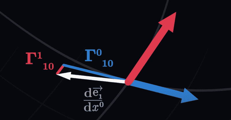

The Christoffel coefficients are scalar real numbers that encode the change of each basis vectors, in terms of those same basis vectors themselves, at every point.
1. Polar transformation
We define a transformation between coordinates ##\{x, y\} \rightarrow \{a,b\}## as follows:
$$ x := a \cos b $$
$$y := a \sin b $$
Thus any vector ##\vec r ## in xy coordinates can be represented also as
$$\vec r = \begin{pmatrix} a \cos b \\ a \sin b \end{pmatrix}$$
in terms of ab coordinates.
We define basis vectors ##\vec E_a, \vec E_b## as follows:
$$ \vec E_a = \frac{d \vec r}{da} = \begin{pmatrix} \cos b \\ \sin b \end{pmatrix} $$
$$ \vec E_b = \frac{d \vec r}{db} = \begin{pmatrix} -a \sin b \\ a \cos b \end{pmatrix} $$
and coefficients set ##C_{ij}## as follows:
$$ C_{ij} = \frac{d \vec i}{dj} = \Gamma_{ij}^a \vec E_a + \Gamma_{ij}^b \vec E_b$$
Permuting over all possible combinations of i and j, we obtain
$$ C_{aa} = \frac{d \vec E_a}{da} = \begin{pmatrix} 0 \\ 0 \end{pmatrix} = 0 \vec E_a + 0 \vec E_b $$
$$C_{ab} = \frac{d \vec E_a}{db} = \begin{pmatrix} - \sin b \\ \cos b \end{pmatrix} = 0 \vec E_a + \frac{1}{a} \vec E_b $$
$$C_{ba} = \frac{d \vec E_b}{da} = \begin{pmatrix} - \sin b \\ \cos b \end{pmatrix} = 0 \vec E_a + 0 \vec E_b $$
$$C_{bb} = \frac{d \vec E_b}{db} = \begin{pmatrix} -a \cos b \\ -a \sin b \end{pmatrix} = -1 \vec E_a + 0 \vec E_b $$

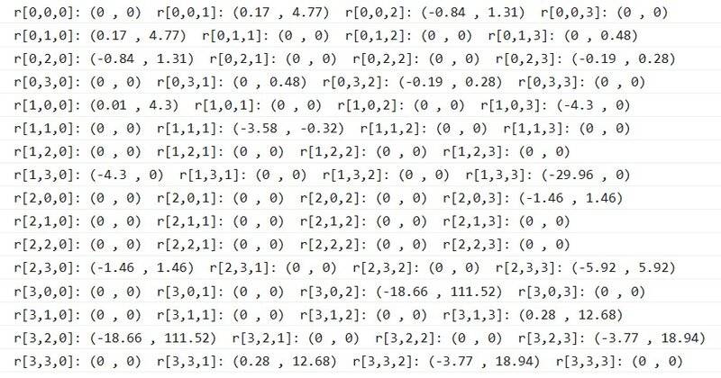

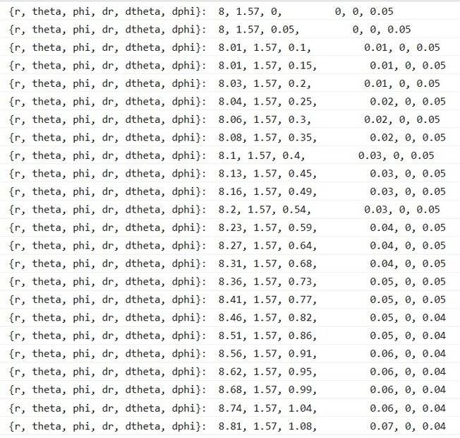

For the case of the earth surface, where the longitude and latitude coordinates ##\{a,b\}## are mapped onto three dimensional ##\{x,y,z\}## coordinates as follows (latitude is defined as 0 at the north pole, 180 degrees at the south pole):
$$ \vec r = \begin{pmatrix} \cos b \sin a \\ \sin b \sin a \\ \cos a \end{pmatrix} $$
It can be calculated that the 8 Christoffel coefficients will be:
$$ \Gamma^a_{aa} = 0 , \Gamma^b_{aa} = 0 , \Gamma^a_{ab} = 0 , \Gamma^b_{ab} = \frac{\cos a}{\sin a}$$
$$ \Gamma^a_{ba} = 0 , \Gamma^b_{ba} = \frac{\cos a}{\sin a} , \Gamma^a_{bb} = -\cos a \sin a , \Gamma^b_{ab} = 0$$
which reduces the geodesic path conditions to:
$$ \frac{da}{ds^2} - \cos a \sin a \frac{db}{ds} \frac{db}{ds} = 0$$
$$ \frac{db}{ds^2} + \frac{\cos a}{\sin a} \frac{da}{ds} \frac{db}{ds} +\frac{\cos a}{\sin a} \frac{db}{ds} \frac{da}{ds} = 0$$
From here, it may be possible to guess a parametrization for ##s## which will force both equations to be identically ##0##.
Following [this] we guess the following parametrization ##s##:
$$ a = a_0 , b = s$$
for some fixed constant latitude ##a_0##, and traveling along the longitude ##b## in the manner of ##s##. Then,
$$ \frac{da}{ds} = 0 , \frac{d^2a}{ds^2} = 0$$
$$ \frac{db}{ds} = 1 , \frac{d^2b}{ds^2} = 0$$
Substituting into the geodesic path conditions, we get:
$$ - \cos a_0 \sin a_0 = 0 $$
$$ 0 = 0 $$
The second equation is identically zero. The first equation can be ##0## if either ##\sin a_0 = 0##, which correspond to the singular point path at the north pole or south pole, or ##\cos a_0 = 0##, which corresponds to a path along the equator.
By spherical symmetry, all paths along the "widest diameter of the earth" is therefore also a geodesic path. A geodesic path on the earth surface is a plane the cuts through the center of the earth sphere connecting the two locations.

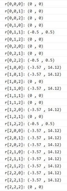

1. In the case of 2D plane ##\{a,b\}## embedded onto a 3D surface ##\{x,y,z\}## in the manner of above:

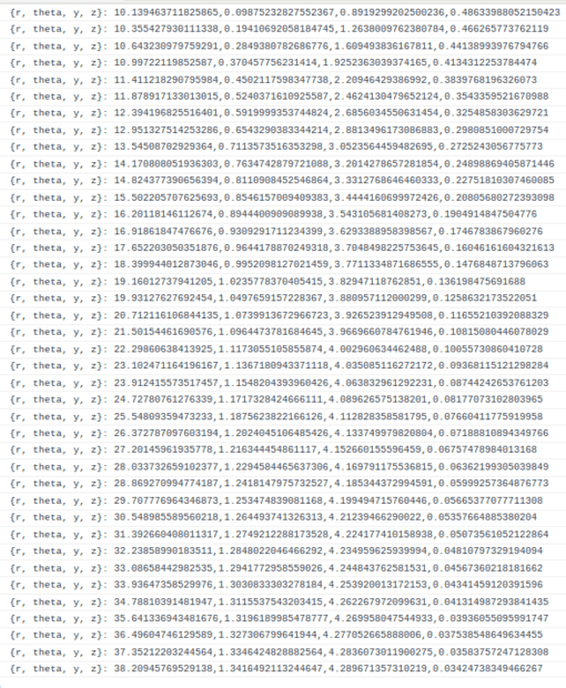

The numerical values of the various Christoffel coefficients are checked to be in the range:
which agrees with analytically parametrized values for ##\Gamma## above. The zero values satisfying all the geodesic conditions are found only on the line going through the equator:

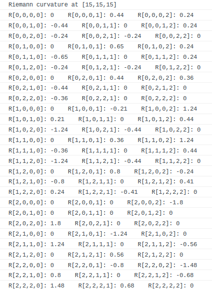

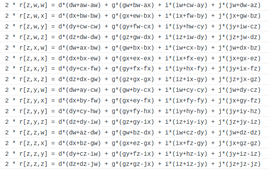

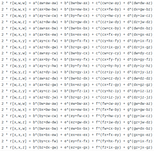

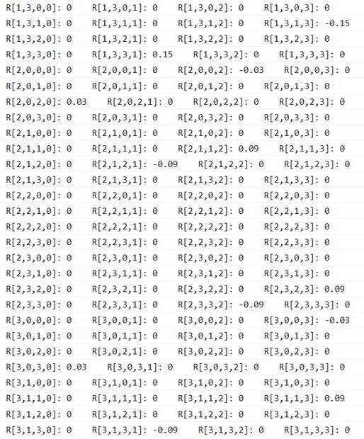

2. We extend the dimension by one, into the case of a 3D volume ##\{a,b,c\}## being embedded onto a 4D surface ##\{w,x,y,z\}## in the manner of:
$$ \vec r = \begin{pmatrix} \cos a \\ \sin a \cos b \\ \sin a \sin b \cos b \\ \sin a \sin b \sin c \end{pmatrix} $$
The numerical range of the Christoffel coefficients are:
Likes topsquark
1. Removing the terms of ##\Gamma## which are identically zero, the geodesic conditions reduce to the set of 3 equations:
$$ \frac{d^2a}{ds^2} + \Gamma^a_{bb}\frac{db}{ds}\frac{db}{ds} + \Gamma^a_{cc}\frac{dc}{ds}\frac{dc}{ds} = 0$$
$$ \frac{d^2b}{ds^2} + \Gamma^b_{aa}\frac{da}{ds}\frac{da}{ds} + \Gamma^b_{ab}\frac{da}{ds}\frac{db}{ds} + \Gamma^b_{ba}\frac{db}{ds}\frac{da}{ds} + \Gamma^b_{ca}\frac{dc}{ds}\frac{da}{ds} + \Gamma^b_{cc}\frac{dc}{ds}\frac{dc}{ds}= 0$$
$$ \frac{d^2c}{ds^2} + \Gamma^c_{aa}\frac{da}{ds}\frac{da}{ds} + \Gamma^a_{av}\frac{da}{ds}\frac{db}{ds} + \Gamma^c_{ac}\frac{da}{ds}\frac{dc}{ds} + \Gamma^c_{bb}\frac{db}{ds}\frac{db}{ds} + \Gamma^c_{bc}\frac{db}{ds}\frac{dc}{ds} $$
$$+ \Gamma^c_{ca}\frac{dc}{ds}\frac{da}{ds} + \Gamma^c_{cb}\frac{dc}{ds}\frac{db}{ds}= 0$$
Following similar reasoning as in the lower dimension, there must be a geodesic path traveling along one axis (while keeping the other 2 axes constant), so that this path can be rotated into any other geodesic path on the hypersphere.
Testing ## a = s, b = b_0, c = c_0## does not give any path where the geodesic equations are zero everywhere.
Testing ## a = a_0, b = s, c = c_0## also does not give any path where the geodesic equations are zero everywhere.
Testing ## a = a_0, b = b_0, c = s## yields the numerical solution by setting ##a = \frac{\pi}{2}## and ##b = \frac{\pi}{2}##, ie. into the midpoint of the ab plane. The 3 geodesic conditions equals 0 for all s, using these setting.
By symmetry argument, all higher dimensional spheres should also have a geodesic line at the midpoint at all the other coordinates, while travelling along the line of a special axis.

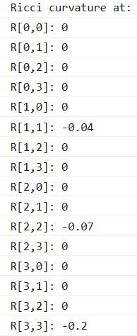

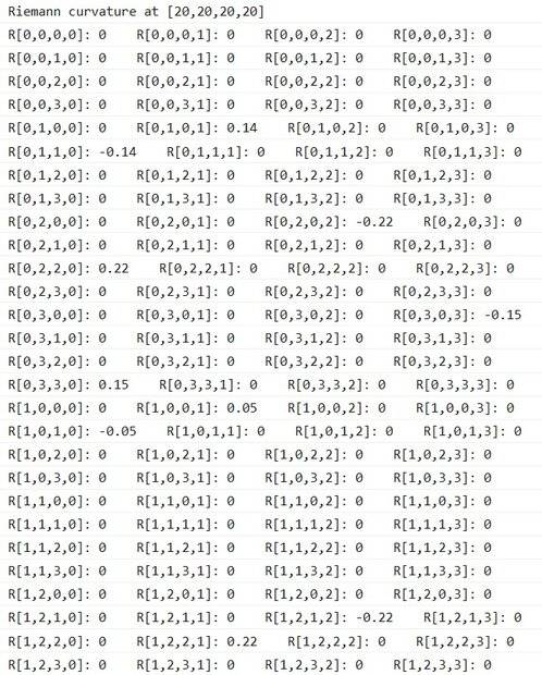

2. The Riemann curvature tensor can be calculated once the Christoffel coefficients ##\Gamma## are known everywhere, according to the formula:
$$ R^i_{jkl} = \frac{d\Gamma^i_{jl}}{dk} - \frac{d\Gamma^i_{jk}}{dl} + \Gamma^i_{\Sigma k} \Gamma^\Sigma _{jl} - \Gamma^i _{\Sigma l} \Gamma^\Sigma _{jk}$$

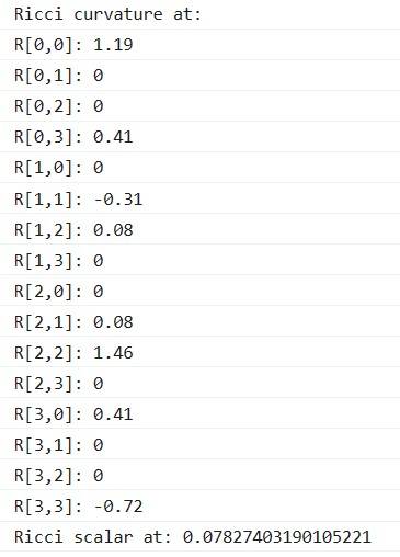

3. The Ricci curvature is a trace-like summary of the Riemann curvature according to the formula:
$$ R_{ij} = R^a_{iaj} + R^b_{ibj} + R^c_{icj}$$
4. The Ricci scalar can be calculated using the Ricci curvature and the ##g^{ij}## values at each point:
$$ R = g^{aa}R_{aa} + g^{ab}R_{ab} + g^{ac}R_{ac} + g^{ba}R_{ba} + g^{bb}R_{bb} + g^{bc}R_{bc} + g^{ca}R_{ca} + g^{cb}R_{cb} + g^{cc}R_{cc}$$
5. The left hand side of the general relativity field equation requires one more constant ##\Lambda =2.036 \times 10^{-35} ## and is calculated at each point according to the expression:
$$ R_{ij} + R g^{ij} + \Lambda g^{ij} $$

The numerical ##4 \times 4 \times 4 \times 4 = = 256## Riemann curvature are not identically zero:
However, the ##4 \times 4 = 16## Ricci curvature are zero:
The 1 Ricci scalar is also (likely) zero:

Setting for instance ##M=1##, and using ##\Delta s = 0.2## and initial conditions ##r=10, \theta=0, y=0.5, z=0.5## yields the numerical ##r## and ##\theta## path as follows:

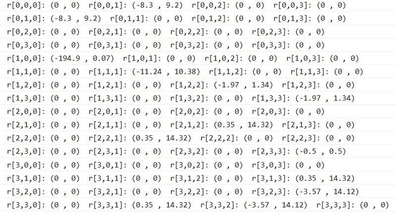

2. To solve for the full geodesic equations in 4 dimensions, we may rewrite ##\frac{dt}{ds} = w##, ##\frac{dr}{ds} = x##, ##\frac{d\theta}{ds} = y## and ##\frac{d\phi}{ds} = z##, to obtain a total of 8 first-order simultaneous equations:
$$\frac{dt}{ds} = w$$
$$\frac{dr}{ds} = x$$
$$\frac{d\theta}{ds} = y$$
$$\frac{d\phi}{ds} = z$$
$$\frac{dw}{ds} = - \frac{2M}{r(r-2M)}xw$$
$$\frac{dx}{ds} = - \frac{M(r-2M)}{r^3}w^2 - \frac{M}{r(r-2M)}x^2 + (r-2M)y^2 + (r-2M) \sin^2 \theta z^2$$
$$\frac{dy}{ds} = - \frac{2}{r}xy + \sin \theta \cos \theta z^2$$
$$\frac{dz}{ds} = - \frac{2}{r}xz - 2 \frac{\cos \theta}{\sin \theta}yz$$
Inputting 8 initial values for ##\{t_0, r_0, \theta_0, \phi_0, w_0, x_0, y_0, z_0\}##, we obtain:

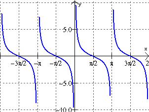

1. The presence of ##\frac{\cos \theta}{\sin \theta}## makes theta a really nasty variable to vary:
We strive to keep ##\theta## unchanging while varying the other nicer variables.

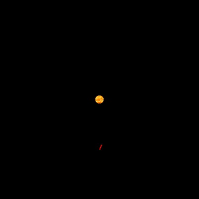

2. Geodesic path bending on Schwarzchild ##g_{ij}##:
3. Unclosed geodesic orbit (precession):
If you aren't letting ##t## vary then those are not orbits on the usual sense of the word.
@Ibix ##t## varies constantly proportional to the t-velocity times ##\Delta s##. In the Schwarzchild metric ##t## doesn't influence anything else, and I took it out of the log mainly because it was hard to read the ##r## values with the ##t## chattering in front of it.

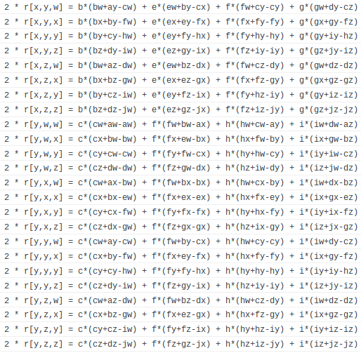

$$ \Gamma^w_{ww} = \frac{a^{\ast}}{2}(a_w + a_w - a_w) + \frac{b^{\ast}}{2}(b_w + b_w - a_x) + \frac{c^{\ast}}{2}(c_w + c_w - a_y) + \frac{d^{\ast}}{2}(d_w + d_w - a_z)$$
$$= \frac{a^{\ast} a_w}{2} + b^{\ast}b_w - \frac{b^{\ast}a_x}{2} + c^{\ast}c_w - \frac{c^{\ast}a_y}{2} + d^{\ast}d_w - \frac{d^{\ast}a_z}{2}$$
1. The Riemann curvature in terms of Christoffel coefficients are:
2. The Riemann curvature in terms of ##\{a,b,c,d,e,f,g,h,i,j\}##, ##\{a',b',c',d',e',f',g',h',i',j'\}## are:
3. The Ricci curvature in terms of ##\{a,b,c,d,e,f,g,h,i,j\}##, ##\{a',b',c',d',e',f',g',h',i',j'\}##, ##\{\frac{d\Gamma_{\Sigma\Sigma\Sigma}}{dw},\frac{d\Gamma_{\Sigma\Sigma\Sigma}}{dx},\frac{d\Gamma_{\Sigma\Sigma\Sigma}}{dy},\frac{d\Gamma_{\Sigma\Sigma\Sigma}}{dz}\}## are:
4. The Ricci scalar in terms of ##\{a,b,c,d,e,f,g,h,i,j\}##, ##\{a',b',c',d',e',f',g',h',i',j'\}##, ##\{\frac{d\Gamma_{\Sigma\Sigma\Sigma}}{dw},\frac{d\Gamma_{\Sigma\Sigma\Sigma}}{dx},\frac{d\Gamma_{\Sigma\Sigma\Sigma}}{dy},\frac{d\Gamma_{\Sigma\Sigma\Sigma}}{dz}\}## is a monster calculation:
5. Each of the 10 field identities in terms of ##\{a,b,c,d,e,f,g,h,i,j\}##, ##\{a',b',c',d',e',f',g',h',i',j'\}##, ##\{\frac{d\Gamma_{\Sigma\Sigma\Sigma}}{dw},\frac{d\Gamma_{\Sigma\Sigma\Sigma}}{dx},\frac{d\Gamma_{\Sigma\Sigma\Sigma}}{dy},\frac{d\Gamma_{\Sigma\Sigma\Sigma}}{dz}\}##, ##\{T_{a},T_{b},T_{c},T_{d},T_{e},T_{f},T_{g},T_{h},T_{i},T_{j}\}## is:
