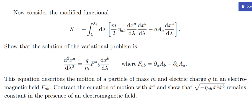

I've attached the problem statement as an image.
Euler Lagrange equations
I've also attached my attempt as a pdf file. My main issue seems to be I only get one A partial term. Any help would be appreciated.

I've just realized my mistake. the partial of q A_b with respect to lambda isn't zero, you get an extra term from the chain rule and it works out nicely.
