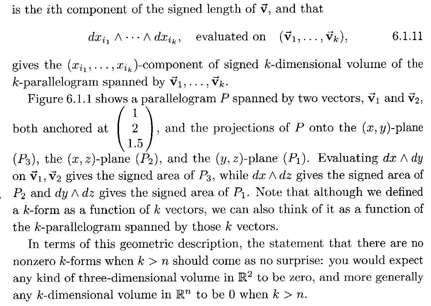

I am reading the book: "Vector Calculus, Linear Algebra and Differential Forms" (Fourth Edition) by John H Hubbard and Barbara Burke Hubbard.
I am currently focused on Chapter 6: Forms and Vector Calculus ...

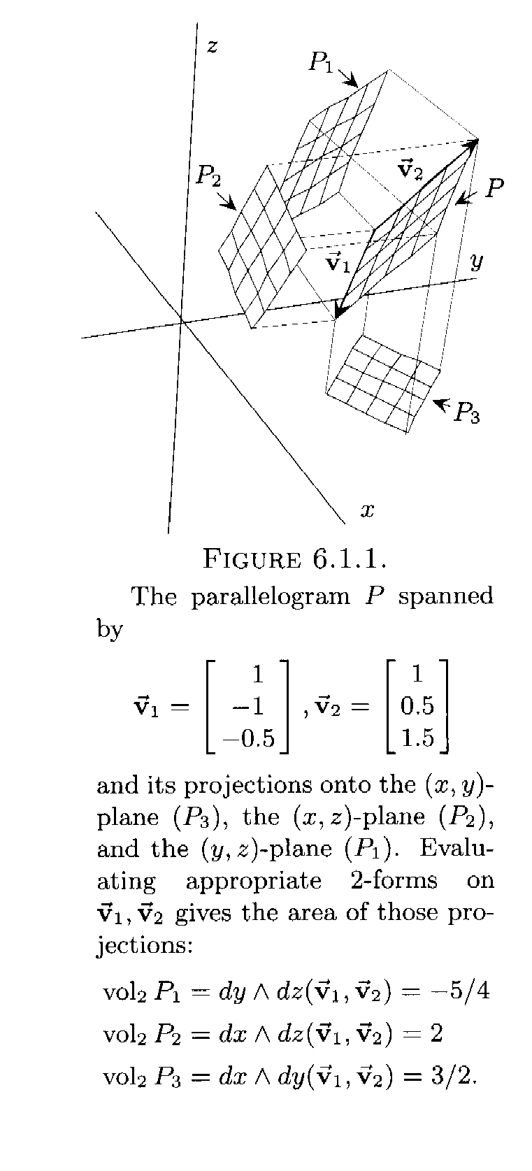

I need some help in order to understand some notes by H&H following Figure 6.1.6 ... ...
Figure 6.1.6 and the notes following it read as follows:
View attachment 8628My question regarding the notes following Figure 6.1.1 is as follows:
What is the meaning/significance of the terms \(\displaystyle \text{ vol}_2\) preceding \(\displaystyle P_1, P_2\) and \(\displaystyle P_3\) ... indeed I can see no need for the terms at all ...
Can someone please clarify this issue ...

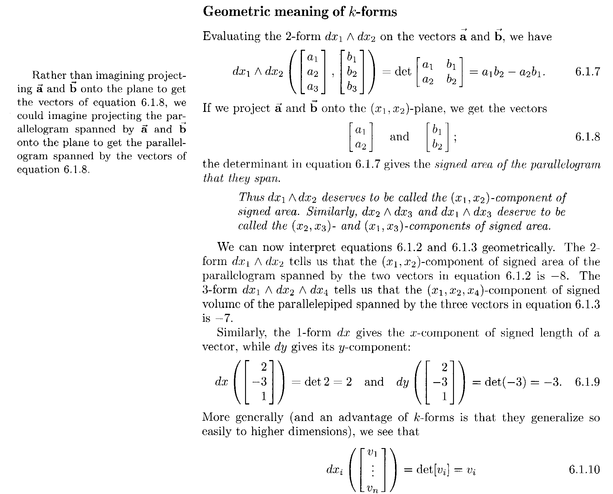

Peter=========================================================================================It may help MHB readers of the above post to have access to H&H's section on the Geometric Meaning of k-forms ... so I am providing the text of the same ... as follows:
View attachment 8630Hope that helps ...
Peter

Hi Peter
I do not think that the notation is superfluous, but a better notation would be $vol_2(P_3)$, etc.You have a parallelogram $P$ spanned by $\vec{v_1}$ and $\vec{v_2}$ in three dimensional real space.
$P_3$ is the projection of $P$ on the $(x,y)$-plane.
$vol_2()$ is the action to compute the area of a plane, that is,
$vol_2(P_3)$ is the area of $P_3$

Thanks for the insight and help, Hugo ...
Appreciate your help ...
Peter
