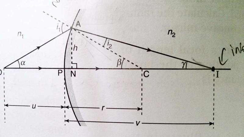

A sphere of radius 12.0cm has refractive index of 1.33. A speck is 4.0cm from the centre of the sphere is viewed along the diameter that passes thru the speck. Find the position of image when the speck is viewed from the nearer side?
the ans is -7.2cm
n1= 1.33 n2= 1 , u = +0.08m. Assuming light travel form right to left , The nearer position from the speck to the left refracting surface is +0.08m. so this lead me to (1.33/0.08) +1/(v) = (1-0.33)/(-0.12) , my v is -0.05m . r is negative because the refracting surface is concave to the object. i just can't understand why I am wrong ? please help! p/s : the speck is inside the spherical (ball) am i right?

sorry it should be (1.33/0.08) +1/(v) = (1.33-0.33)/(-0.12) where my v is -0.05m . what's wrong with it?

n1= 1.33 , n2 = 1.00 , so n1-n2= 1.33-1.00

i am using modulus of n2-n1, as in the book. is there's anything wrong with the equation?

... well, only that you just told me that you did:
But you told me that n1=1.33 and n2=1 (post #1) ... so where did that 0.33 come from, and why is n1 first?
What you wrote there does not match your notes, and nor does it match the link I gave you.
surely: n2 - n1 = 1 - 1.33?
Try doing the algebra one line at a time. Be super careful: you appear to have a blind spot there.

n1 = 1.33 , n2= 1.00 , u = +0.08 , n1-n2 = 1.33-1.00=0.33 , r = -0.12
(1.33/0.08) + (1/v)= (0.33/-0.12) , the v i get is still -0.0516m . i can't figure out which part i did wrongly

but suprisingly if I take r = +0.12 , i got the ans which is 0.072m . by taking r= -0.12 , i assume the refreacting surface is concave relative to the incident light ray.
We don't normally do the problem for people, but you are stuck on the substitution and you have sincerely tried hard.
... the bold face is incorrect.
What is supposed to go in there is n2-n1 and you wrote down n1-n2.
It is very important to write down the equation you are using with all symbols before you do any substituting.
Using:$$n_1=1.33,\; n_2=1,\; o=8\text{cm},\; v=\text{?},\; R=-12\text{cm}$$
$$\frac{n_1}{o}+\frac{n_2}{v}=\frac{n_2-n_1}{R}\\
\implies \frac{1.33}{8}+\frac{1}{v} = \frac{1-1.33}{-12} = \frac{0.33}{12}\\
\implies v= \left( \frac{0.33}{12}- \frac{1.33}{8} \right)^{-1} = -7.21\text{cm}$$ ... now do you see what happened?
