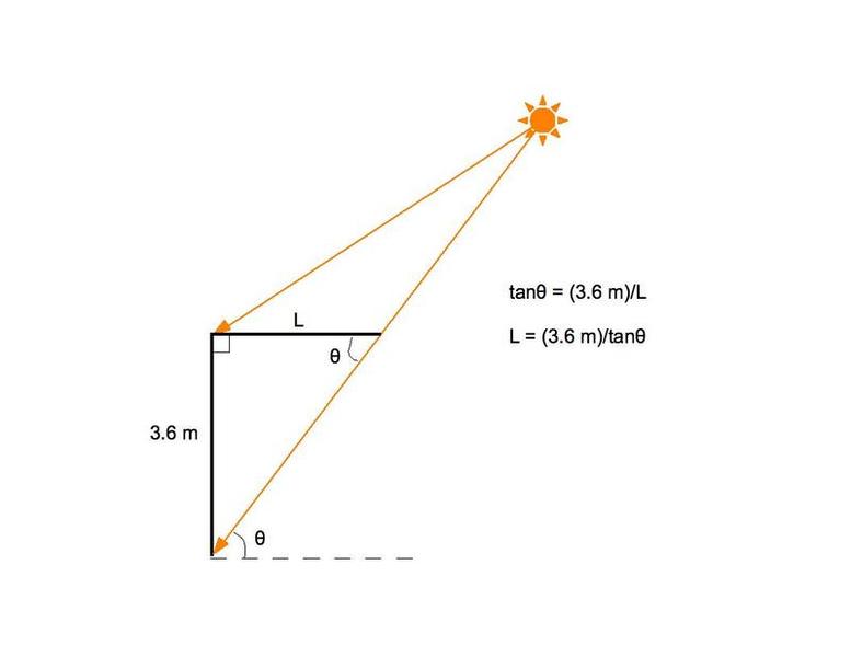

I am trying to figure out what size eaves we need for our house extension.
I've tried a few calculations and now I'm posting here in the hope that a logical thinker will be able to tell me what I'm doing wrong.
We live in Adelaide, Australia, and we want to put in glass double-doors on a north-facing wall.
The glass doors are 2.7 metres high. The height from the floor to the underside of the eaves is 3.6 metres.
I've found 3 ways to calculate the desired eave length.
Method 1.
To use the sun angles for particular dates.
I've only been able to find 3 relevant sun angles - the elevation angles of the sun at a). the summer solstice (Dec 22), b). the equinoxes (March 21 and September 23), and c). the winter solstice (June 21).
The angles are a). 79deg (approx only, this is for Sydney), b.) 56deg (again, approx only, this is for Sydney) and c.) 31deg (apparently this is correct for Adelaide).
If we want to block the sun between the equinoxes, from Sept 23 until March 21, then the
eave length = 3.6/tan56 = 2.43 metres.
but this seems awfully long.
I can also calculate the penetration of winter sun if the eave was 2.43 metres, and that would be = ( 3.6 - (tan31*2.43) )/tan 31 = 3.56m
which = 3.56m

You seem like you know what you're doing geometry-wise. In addition to the sun elevation, the sun azimuth (compass direction, essentially) matters as well. I mean, it's not a problem if the sun isn't shining through your door in the first place! However, since you're in the southern hemisphere, the sun will indeed be due north at local high noon, which is the time at which it also has its highest elevation angle. So if this is a north-facing door, then it'll be getting a lot of sun. I'm guessing that you already know that, which is why you are carrying out this exercise.
The diagram below shows my reading of the situation:
The two rays that are drawn are the extremal rays, the ones that hit the wall at its highest and lowest points respectively. In order to block out the sun, all rays in between these two must be blocked, necessitating a horizontal eaves of length "L" as shown in the figure. The elevation angle of the sun is indicated using the Greek letter theta (θ). From the right triangle formed by the eaves, the wall, and the lower ray, you can solve for L using simple trigonometry. So it would seem from the geometry that the equation you used is indeed correct.
Now, here's the thing: this assumes that you want to block out the sun entirely. However, in practice, this may not be necessary. The rays that are closer to horizontal are a problem, because they hit higher up on the door, and hence will penetrate farther into your house, which might fade your furniture etc. However, the steeper (more vertical) rays that hit lower down on the door will not penetrate nearly as far into your house. This means that it may not be necessary to block the sun from shining through the lower portion of the door. It's up to you to decide how far into the room is acceptable. For instance, if you decide that the unblocked rays shall hit the floor no farther than 1.0 m into your house, then the situation is as shown in the second diagram below:
The ray with the dashed line is now the steepest one that gets blocked. So now you have a couple of right triangles, and you can use them to solve for L. (I gather from your original post that you already knew how to do this as well). For θ = 56° and an illumination that extends no farther than 1.0 m along the floor, I get that L = 1.43 m, which saves you a whole metre of material! So that's something to take into consideration. Is it OK if a small portion of the floor just inside your door is illuminated?

Thankyou cepheid.
Your reading is absolutely correct. I also like your point about whether I need to block the sun completely at the equinox or whether the sunlight can penetrate some distance at these dates. And thank you too for pointing me to Stellarium.
So now I think my calculations were ok and the issue is the dates I want the sun completely blocked.
I've tried re-doing the calculations.
Adelaide has really hot summers. February is usually the hottest month, and it is not unusual to get days that are 40 deg C in February so I think I'd want the sun blocked until at least March 1.
I used Stellarium and got a sun elevation angle of 66.95deg at noon on March 1, 2012 (tomorrow in fact!).
This gives me an eave length of 2.52m. Still very long.
So maybe there is no way around it with eaves alone. Perhaps I have to be happy with a shorter eave length, and then on hot days outside of the dates covered by the eaves I have to just put up with it and make sure i have thick, blockout curtains. Or get shutters or something.

BTW, cepheid's diagram is fine except that all rays from the Sun should be drawn parallel (or as near as dammit). So you can't really include the Sun in the diagram.
