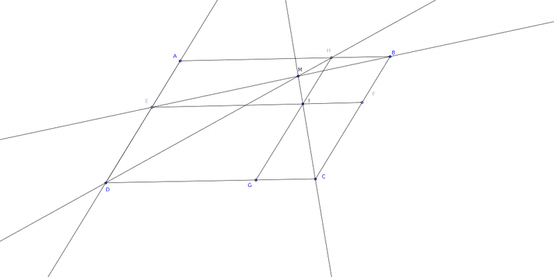

On the picture, ##ABCD## is a parallelogram, ##(EF) // (AB) ##, and ##(GH) // (BC)##.
The problem is : show that lines ##(EB)##, ##(HD)##, and ##(IC)## either all meet in ##M##, or are parallel.
I've solved the problem introducing a coordinate system ##(D,\vec {DG},\vec {DA} )##, but this was the 'last chance' idea. I don't like it too much, it is a little messy, and I suspect there are simple ideas that could be used and that I didn't see. So my demand is rather for insights. How would you solve it ? Thanks !

Parall AHGD less parall ABFE equals parall BCKJ. Three parallelograms similarly oriented in the plan; and adjoining neighbors. To find point J, just extend linear segment IC across segment AB. Side JK of the third parallelogram, is parallel to side BC. Any such a trio of parallelograms, induces a commun point of one of their respective diagonals. A theorem to be proven.

You can simplify the geometry by thinking about plane projections.

What do you mean ? You may give your detailed solution as the exercise is already solved, it's just that I really feel that mine is longer than it needs to be.
It consists in fitting a coordinate system on the parallelogram, finding the cartesian equations of (EB), (HD), and (IC), and start working on the following alternative: two of these lines either meet at a point or are parallel. This alternative translates algebraically when one tries to solve the system of their cartesian equations.
If this algebraic condition is satisfied then the solution of the system is also a point of the third line, if not, they are mutually parallel.

If you take a photograph of a rectangle, but not square on, you get a parallelogram. You can reverse that by a suitable plane projection to convert a parallelogram to a rectangle. Straight lines are conserved, so without loss of generality you can consider only the case in which the shapes are rectangles.
However, I don't know whether that helps much. I suppose it would help with the algebraic approach.

Continuing the idea, we can normalise the outermost rectangle to a unit square. So now there is only pair of variables, the coordinates of the interior point. Certainly the algebra is now fairly straightforward. Similar triangles produce three equations relating this (x,y) to the coordinates of the intersection point, and it is easy to see that one can be deduced from the other two. I was hoping this would lead to some insight regarding the geometric argument, but I don't see it yet.

Labelling the vertices A, B, C left to right across the top, D, E, F across the middle, etc., ACIG forms a square. Make it a unit square with G as origin. Point E has coordinates (x,y), and the point of intersection of CD and BG is (u,v). Use similar triangles to express u and v in terms of x and y. Etc.
