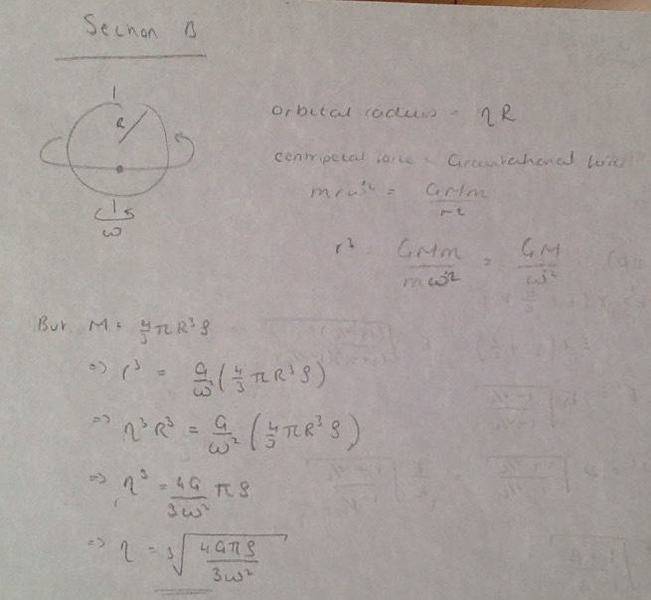

Okay, so the question seems really simple so I don't know what I'm missing
A satellite orbits at a fixed point above the Earth's equator. Assuming the Earth has uniform
density, radius R, and angular frequency of rotation, omega
Find an expression for eta, such that the orbital radius of the satellite is expressed as eta R
Below
Centripetal force= gravitational force
mr(omega)^2=GMm/r^2
r^3=GM/(omega)^2
But I honestly have no idea how to incorporate the Eaths radius. Every time I try it cancels.
Thanks in advance :)
When calculating mass of the Earth you can use density and radius of the Earth so it doesn't cancel out.

Sorry - I've just had a thought. That will give me an expression in terms of R^3, not R. This produces the same problem as I had before
I don't understand the problem exactly. Any function dependent on R is actually an expression in terms of R so if you obtain a term with R^3 (you should) don't worry because it means that radius of the sattelite is not dependent on R linearly .
There are two different radii involved: One is the radius of the Earth and the other the radius of the orbit. The volume is calculated using the Earth radius R, while the satellite orbit is a multiple of R. Replace the radius in your satellite force balance with ##\eta R##.

Ah okay - I think I've got it now. Thank you. Of course- would you like me to upload a photo of my working? (For some reason Latex doesn't work on my computer)

Thank you- please excuse my handwriting.

Your solution looks good.
