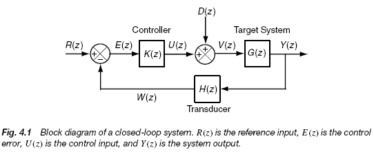

Hello guys!
1 & 2:
I would like to get some help to take everything in A and find transfer function at B and C.
I can't find these answer...
3.
I know how to go from b) to c) .. we only multiply by E(s) and B(s). But I can't find b) at first.
Thanks so much!

Is there any more detail you can assist with this? For example, where is Vm located? Where is ΩM?
Your F(s) expression seems incomplete.
I think omega m is wm.
Here is mechanical drawing from where my block diagram came. Sorry it is in french.
a) should link motor electric supply Vm to speed of shaft in rotation. (Wm)

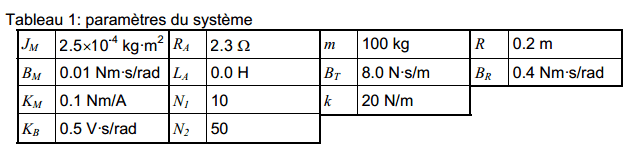

You checked F(s) as I suggested?
F(s) is ok. Here is why (this is a list of all the parameter): La = 0.0H
  • Why this table, everything that can help find a solution is here.

We want to know position x(t) of mass m with the help of a DC moteur and a gear system. All system elements are shown on picture 2.
a) With the use of block diagram (first picture I posted) and parameters (in my last picture), find transfer function of every system elements. Consider initial condition to zero.
b) Simplify the block diagram found in (a) to obtain the transfer function between the power supply of the motor and the speed of rotation of its shaft.
c) From the transfer functions found in (b), find one that connects the motor electric supply to the displacement of the mass x (t). Determine the order of the system.

Well I know how to get transfer function when I got Input and Output. (I only simplify my diagram). But I don't know how to get my transfer function when it is not between input and output. (There's no output..)
Like this:

I'm not sure I understand what you mean. In (b), for instance, you're asked to find the transfer function ##\frac{\omega_M(s)}{v_M(s)}##, i.e. ##v_M(s)## is the input and ##\omega_M(s)## is the output.
In other words, you have to simplify the diagram so you have:
##v_M \rightarrow##some transfer function##\rightarrow \omega_M##
I don't know where to split my diagram to get wm as an output. What are the transfer function useless, etc.
What does it mean, in a diagram, for a signal to be an output? How can you tell that ##\omega_M## isn't an output in the first diagram you posted?
In my idea an output is like my last picture y(Z), when there is nothing after it.
That depends on your point of view. Would it help if you drew an arrow out from ##\omega_M## in your first diagram? There's nothing more to the right of that either.
Yeah you're right.. I'll try tonight!
If you take the view that ##\omega_M## is the output, then it's helpful to realize that there's then just a simple feedback loop around H(s), which you can simplify using the rules for blocks in series, parallel and negative feedback.

Just use algrebra!
My guess, you are trying to use formulas, just derive the equation yourself.
Lets start by defining Wm.
Wm=H(s)*(Ia*G(s)-Tm)
Ia=(Vm-Vb)*F(s)
etc...
