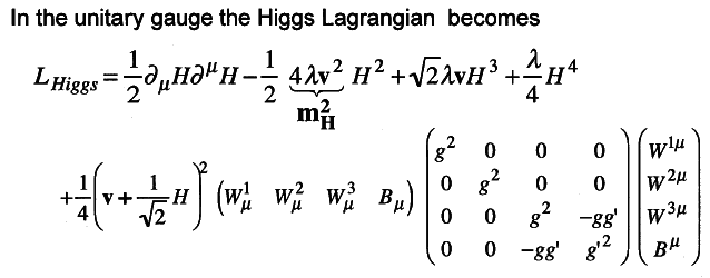

OK, so, I found slides with the following:
So we have a non-diagonal 4x4 matrix in that last term. This must be what you mean. And when it's diagonalised, the corresponding eigenbasis [itex](W^{+}, W^{-}, Z^{0}, \gamma)[/itex] is related to this [itex](W^{\mu 1}, W^{\mu 2}, W^{\mu 3}, B^{\mu})[/itex] basis by
[itex] Z^{0} = \frac{g}{\sqrt{g + g'}} W^{\mu 3} - \frac{g'}{\sqrt{g + g'}} B^{\mu} [/itex]
[itex] \gamma = \frac{g}{\sqrt{g + g'}} W^{\mu 3} + \frac{g'}{\sqrt{g + g'}} B^{\mu} [/itex]
That seems straightforward enough. But where do 'eaten Goldstone bosons' come in?
