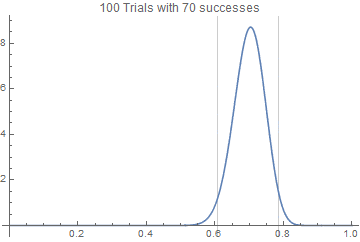

So let's collect 10 times the data, and suppose that after collecting 100 results we find exactly 70 successes. Surely we can be confident now! In fact, we are substantially more sure of our estimate at this point. But even with 100 trials, the 95% credible interval goes from about 0.61 to about 0.79, which is still pretty broad even after 100 trials.
We can continue to collect data, and we will continue to narrow that 95% credible range, but it will never go to 0 and we will never be certain of the exact probability for any finite amount of data.
