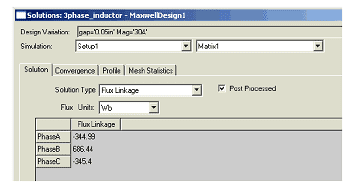

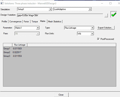

I'm new to ANSYS Maxwell and I'm trying to follow the inductance calculation example in the user's guide.
The results for the inductance are pretty close but the value of flux are very low. What cause this? What should I do?

I've never used Maxwell, but check the core construction. Particularly is the bottom bar of the core both the correct material and in the correct position? See pg 5.2-7, and surrounding, of your attached PDF.
Cheers,
Tom
Cheers,
Tom
Thank you Tom.
I've checked and I think that the material and dimensions of the model are correct.
