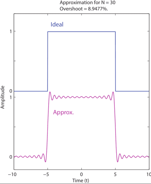

A seemingly good way to understand the overshoot and decay (ringing) of a square wave on a scope is that it is the result of bandwidth limiting. In that case, the Fourier series of a square wave
[tex]\Pi(t) = \frac{1}{2 \pi} \sum_{n=-\infty}^\infty \frac{\sin(n \omega/2)}{n \omega/2} \exp(i n \omega t)[/tex]
shows the well-known overshoot when n is only taken to a small number, such as 30, terms.
It's obtained by Fourier transforming the rect function [itex]\Pi(t)[/itex] to get [itex]\mathrm{sinc}(\omega)[/itex], then transforming back to the time domain, except you form a Riemann sum instead of an integral and take finite terms.
But this calculation doesn't reproduce what you really see on a scope, because it appears to be non-causal. That is, before the machine that drives the signal starts to apply voltage (at [itex]t=-5[/itex] in the plot), this curve is already ringing. There's a few references to the causality being related to the Kramer's-Kronig relations, especially in the "Understanding the Kramers-Kronig Relation Using A Pictorial Proof" white paper availble online (here). In that they suggest forming a causal function, where it is zero for all [itex]t < 0[/itex], which we could do by translating the rectangle function so that its rise is at [itex]t=0[/itex]. Then form even and odd functions out of the signal. When you do this, the odd function is the same as the even function times [itex]\mathrm{sgn}[/itex]. However, this seems to be of little help, particularly because finding the Fourier transform of the odd part
[tex] h_o = \mathrm{sgn}(t) h_e = (1/2) \mathrm{sgn}(t) \Pi(t) [/tex]
involves a convolution of [itex]\mathrm{sinc}[/itex] and [itex]1/i \omega[/itex], which is quite difficult (Wolfram integrator gives an answer that is not pure imaginary, which shouldn't be true).
What am I missing here? Is there a way to present the real signal you see on a scope trace as an instance of the Gibbs phenomenon? If so, is this on the right track? Does anyone know of a treatment of this problem?
You clearly can't hear a bell ring before it's struck.

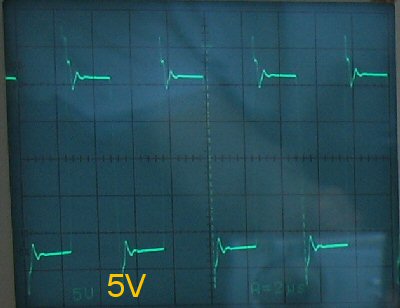

I've not seen real scope traces that look like your "ideal". They normally look like these from the web..
http://www.craigsarea.com/images/good_gate.jpg
http://www.chatzones.co.uk/discus/messages/1218/2480.jpg
http://i.stack.imgur.com/Q0uig.png
Dual beam scope traces can sometimes be misleading because of the way sync and chop/sweep works. The input and output wave form can be shifted so they appear to be non causal. It's not always obvious what feature of an input wave caused what feature in the output.

You should always ascertain what the scope is actually triggering on. Most scopes default to 'Alternate Sweep' (one trace at a a time). If it is on 'Auto trigger' then the fast leading edge in each case sill probably be the time reference for each trace as it is displayed; they will appear to coincide. If you can actually 'trigger on A channel' (or B), then that should show you the two traces in 'real' time relation to each other. Failing that, split the source signal and feed it to the External sync input and sync on that.
For low frequency waveforms it is sometimes possible to 'Chop' between inputs and that will also give the right relative timing (but the chop frequency needs to be a lot higher than the signal repetition frequency.
The actual delay through a filter will be at least as long as the impulse response of the filter, looked at in the time domain.You can never have the cart arrive before the horse.

That was my point; you never get the ideal. When properly measured with a scope, they look like the third picture you linked to. That is, they look like neither of the plots that I drew. They almost look like the approximate curve, which is due to bandwidth limitation caused by parasitic capacitance, inductance, and resistance. Looking at a low duty cycle pulse (so that previous transient behavior has totally died down by the next pulse) given by machines made by DEI, BNC, and Stanford, you always see the ringing behavior. They're real and understandable. One way you can replicate them is to do a SPICE analysis of a square wave pulse and inserting a parasitic circuit. You get ringing. But people say that it's a Gibbs phenomenon example, and I'm having trouble rationalizing the fact that the Gibbs phenomenon predicts noncausal behavior which isn't observed.
Put simply, how can you calculate the trace in the third pic that you linked to?

I guess my inherent prejudice is toward the observations I've made in my work. A 900 V pulser that I work with daily clearly shows this effect of overshoot, and never shows any such behavior before the pulse begins (the duty cycle is quite low). This is simple to understand from a circuit point-of-view; a TTL pulse turns on an FET on the rising edge, and a DC supply quickly energizes the output. Until this TTL pulse is sent, the system would have no knowledge that something is about to happen. Perhaps my usage of "causality" is imprecise.
The voltage waveform doesn't tell the whole story, though. Your pulse generator will have a non linear output impedance. When it is 'off', it will represent a different source impedance from when it is 'on'. If you use a normal oscilloscope, you are looking with a voltage probe, so the volts, when the signal is zero, could be from a 'voltage source' and will appear zero, whatever circuit follows. That could 'wipe out' any voltage variations and give you a flat base. The time constants when the pulse is rising will be shorter than the time constants when the pulse is falling. No double you would see a tiny amount of pre-ringing as the leading edge starts to establish itself and the impedance starts to change.
