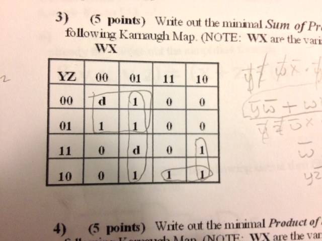

Awesome thanks.. Mind checking this as well?
Minimize Sum of Products equation given the following K map.
My Answer: $$\bar{y} \bar{w} + wx + y\bar{z}w + yw\bar{x} $$

Shouldn't that be $\bar y \bar w+\mathbf{\bar{w}x} + y \bar z w+yw\bar x$
Yes, but $\bar{w}\bar{y}+xy\bar{z}+w\bar{x}y$ is shorter.
Ahh I see. The correct answer is the 3 term answer provided by Evgeny..Looks like I was grouping wrong, or unnecessarilly. Thanks guys.
