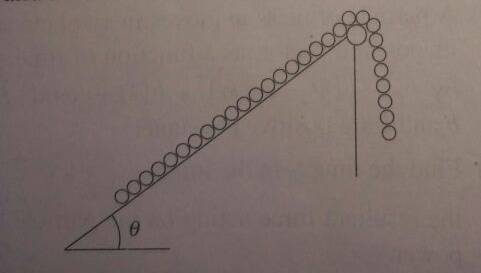

A uniform chain of mass 'm' and length 'l' rests on a rough incline (inclination is angle 'Q') with its part hanging vertically. The chain (inclined) starts moving up the incline (and the vertical part moving down) provided the hanging (vertical) part equals to 'n' times the total chain length. Find the work done by friction as it completely slides off the incline.
Newton's 2nd law
I assumed friction coefficient to be 'u'.
Frictional force would be N u.
I took the inclined part a system to draw the free body diagram.
N = m'gCosQ where m' is the mass of chain on the incline.
Work (fric) = N u s (displacement) x Cos 180° = - m'gCosQ x s
As mass m' will decrease as chain slides up the incline. I considered a small part of chain 'x' of mass dm. As chain is uniform density,
m/l = dm/x => dm = m x /l
For a small work dW
= -dm gCosQ dx
= - (m/l) gCosQ xdx
Let the length of vertically hanging part be 'a'
a/l = n => a=nl
So length of inclined part initially is l-nl
So I integrated xdx putting limits (l-ln) to 0 and got W= mlgCosQ u / 2 but the problem is I'm unable to find a way to write 'u' in terms of given variables.
I was hoping for an idea to find 'u' or any other better method to solve this (within the scope of basic calculus and mechanics).

There is a frictionless pulley at the tip of incline. The dimensions of the pulley is to be neglected.(view image)

The equation I get is W(by friction) = (mlgCosQ(1-n)^2 u)/2

Ok, but now use the hint I gave you at the end of post #2 to find u.
So I take the initial part of chain on incline as a system and draw it's free body diagram. The exernal forceks are normal by surface, gravitational force, friction down the incline and tension up the incline by the other part of chain. But I am finding difficulty finding friction coefficient as it seems to be cancelling each other out in the equilibrium equations. Did I mess up taking the system or making the equations?
Here are my equations;
N=MgCosQ
NCosQ + TSinQ = fSinQ + Mg
NSinQ+fCosQ=TcosQ
f+MgSinQ=T
Where N and f are normal and frictional force exerted by rough surface on inclined part of chain initially and T is tension applied by the other part of chain. As you said, I assumed the system to be in near equilibrium initially so no acceleration.

Those four equations are all obtained by considering force balances on the sloping part of the chain. There are only two dimensions, so only two independent such equations are available. Whichever two you pick, the other two are redundant.
You need to relate the mass of that portion to the mass of the hanging portion (using n) and that to the tension. You also need to relate N to f using u.

Ok so I picked the the equation balancing the forces pulling it up and down the incline.
Hence f + m(1-n)gSinQ = T
So tension here would be equal to weight of the part hanging so T = mng
f=m(1-n)gCosQ u
So on substituting these values in the above equation, I got;
u= [n-(1-n)SinQ]/(1-n)CosQ
And on substituting this value to the Work by friction equation;
Wf= mgl(1-n)(n-(1-n)SinQ)/2
At n=1,Wf=0 (from this equation) which is to be expected as entire chain is hanging now. I hope this equation is correct and would be glad if you confirm it.

Looks right.
