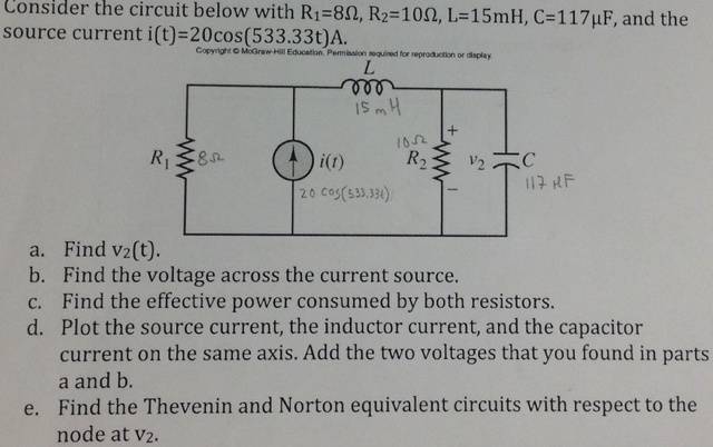

In my Intro to EE class we have a homework assignment with the following problem:
I think I finished part a but want to make sure that I am doing the problem correctly before I move on to the next part.

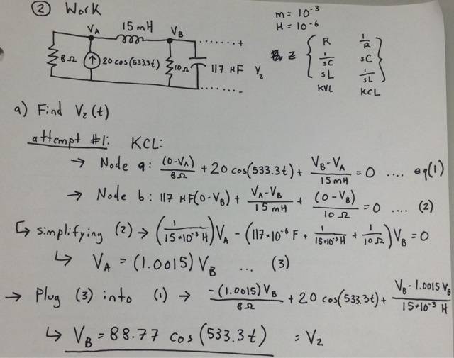

You'll want to work with phasors and impedances; You can't mix Ohms and Henries and Farads in your node equations. So first thing to do is determine the impedances of your reactive components (L and C). These will be imaginary values, in Ohms. Then use these in your node equations.
