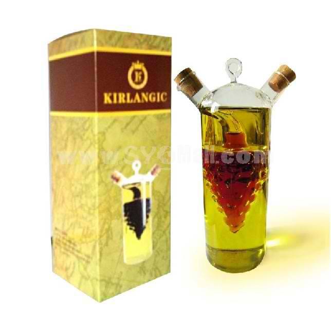

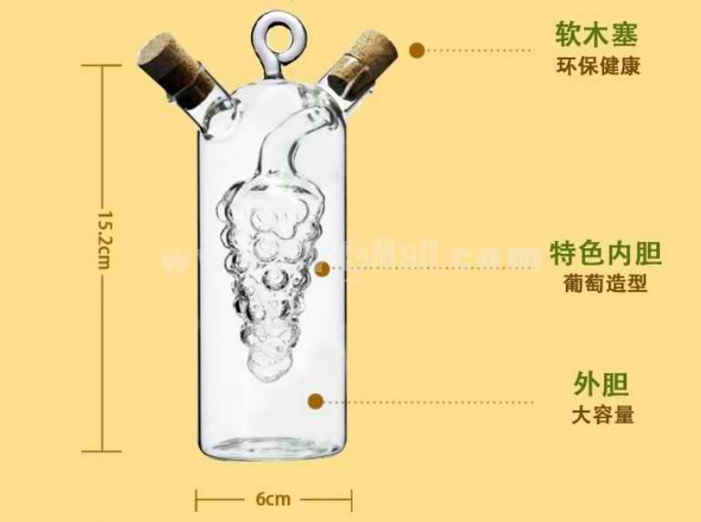

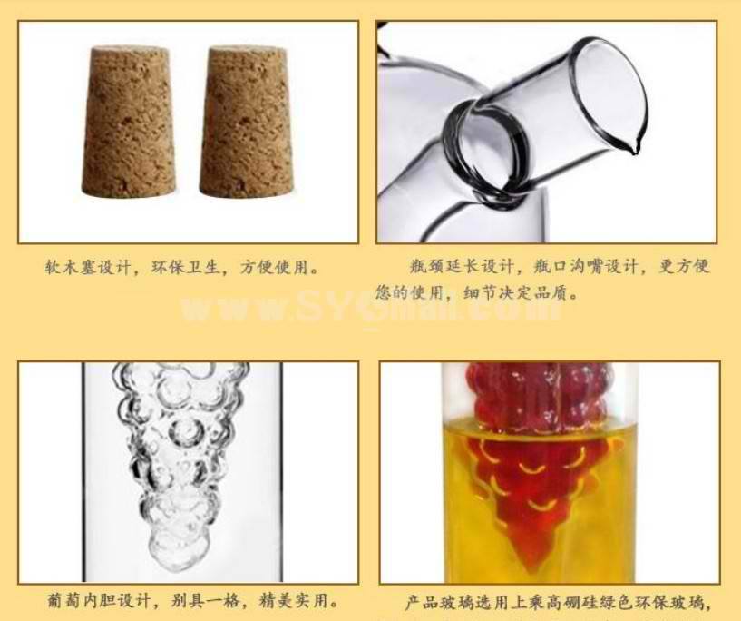

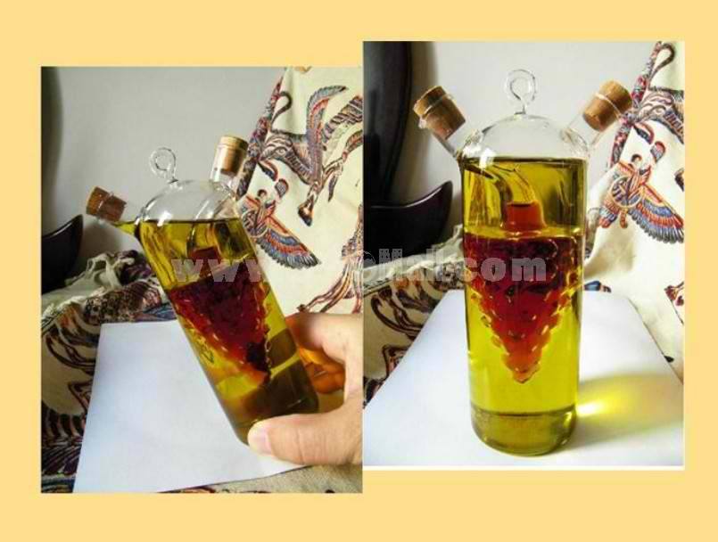

I first thought it were impossible, but then I saw that bottle (see attached images) which seems to be a more complex shape and that made me doubt...

Apparently, you'd be amazed at what glass workers can do. Your shapes are fairly trivial, I believe.
