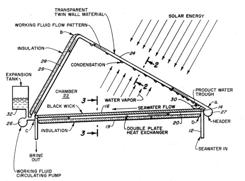

I need to increase the surface area of the glass which will be used in a solar still with the intention of keeping the glass as cool as possible. My first thought was bubble wrap because it's transparent and I thought it would not interfere with the light but then I remembered it is a good insulator and would probably make my glass heat up, so then I was thinking of corrugated glass.
Can someone give me some guidance on other methods to keep the glass cool without using any electricity or any form of human intervention such as pouring water on it.

Potentially dumb idea, but what about a glass sandwich? Two layers separated by a few mm, with open ends at top and bottom, but sealed on the sides. The idea being that as the glass directly on top of the still heats up, the gap to acts as a chimney, drawing in cool air from the bottom.

Not a dumb idea at all. US Patent 4,235,679 from 1979:

What's the guy got with his water flow going the wrong way, and the insulation on the wrong side of the enclosure at the left hand side.?
I guess he/she is trying to do two competing things at once - heating up the seawater and cooling the condensation. hmm.
It looks right to me. It's common to circulate water in contra flow when you want to maximise heat exchange.

Here is how I see it.
Look at the section up top and to the left. In the present configuration,
The water flowing in the section open to sunlight approaches somewhere between the temperature of the condensate and the ambient. It then travels down the section insulated from ambient with no heat flow to the ambient environment, but rather absorbing heat from the vapour due to conduction ( and perhaps some condensation ) and thus approaches the vapour temperature. Next, flowing through the sea water/ water heat exchanger, there is an exchange of heat from the sea water to the water. As the water exits, since its temperature closely resembles that of the liquid sea water, which is being heated by the sunlight, the condensation upon the inner glass is inhibited and performance drops.
The insulation should be on the inner surface so that heat flow can be from the water to ambient, so that the water exits at a lessor temperature than the vapour.
The water flow should be in the opposite direction so that the water enters the section open to sunlight at the lessor temperature.
The salt water/ water heat exchanger configuration serves no purpose. In fact it would be much better to bypass the sea water and avoid bringing the water definitely to the temperature of the salt water.
The vapour and liquid salt water in the closed container well be at the same temperature except in the region where the vapour contacts the glass pane.
If temperature differential is what promotes condensation, then heating up the inside of the glass is better than cooling the outside, because it increases the evaporation rate. Maybe you could focus your attention in that direction. This might even bring you back to your original idea of bubble wrap. Insulation that traps heat inside the container would mean that no matter how hot it gets outside, the heat inside the still will be much greater, insuring a large temperature difference at the glass interface. Dark paint on the inside will also help, and would be pretty cheap.

As (subtly) indicated in the drawing that @jrmichler posted, the heat exchanger circuit is completely separate from the seawater circuit. That is also claim 1.c. in the patent.
c. said passage means in said heat-exchanger base means and in said transparent cover means being filled with a heat-exchanger working fluid;
Addressing the concern of @256bits regarding the position of insulation on the left wall, the insulation is there to conserve the heat recovered from the condensation to add heat to the evaporator... or as @sophiecentaur pointed out that 'waste' heat is recycled to add thermal energy at the evaporator plate, greatly increasing the overall thermal efficiency of the system.
As the evaporator plate is a counterflow heat exchanger, the working fluid is cooled approaching the temperature of the incoming seawater; which is then used to cool the condenser.
Overall a rather clever design!

A good addition to the basic idea. However, I still have a problem with the cooling circuit. I am not convinced that the best method is to use the condensate, which is warm, to cool the condenser. The through flow will be very slow and I can see the upper and lower volumes of water being nearly at the same temperature. Is that a good thing? If there is a good supply of cold seawater then would this not be better for cooling the condenser? The system could be regarded as a heat engine, pumping water from the brine to the condenser, I think. So a bigger temperature difference would / could increase the efficiency and lift more H2O out of the seawater for a given input of solar energy. It would require a separate heat exchanger to allow clean water, cooled by seawater, to circulate and keep the 'window' clear. That water would need to have some biocide in it. Weed and barnacles are clingy little devils.
I have tried to figure out the exact functions in the patent diagram. The separate freshwater circulation seems to be there but, however I look at it, I can't see my idea (above) of an extra heat exchanger included in it. Adding it would be pretty simple as long as there is a surplus of seawater available. Any desalination plant would need to be near the sea because this simple system will perform worse as the seawater becomes more concentrated. There would need to be some optimisation here, between brine temperature and brine flow rate.
